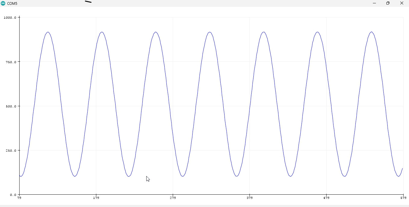

Initially i CALBRIATE the value in first step.. so didn"t get proper sine value while i turning 100k pot also
Connection Arduino to zmpt101b
5V TO VCC
A1 TO OUT (I Checked here in multimeter 2.53v in zmpt101b)
GRD TO GRD
product link zmpt101b
  // Set analoge pin to input
  pinMode(A1, INPUT);
  // Read analog input
  Serial.println(analogRead(A1));
  delay(20);
Here i should get the sinewave but inot geeting properly
please help me to crack this guys and thank you so much

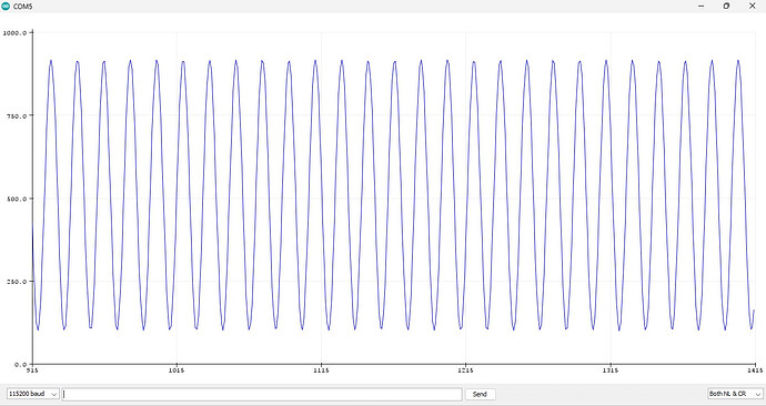

Try this
  pinMode(A1, INPUT);
  Serial.print(analogRead(A1));
  Serial.println();
  delayMicroseconds(800);

delay(20); // wait a full 50Hz sine wave, and measure at the exact same point of the wave
Successive voltage sample will be almost the same as the first one, being at the top of the wave or at zero crossing.

Have you considered how many samples you need to take in 1 cycle to get a sensible wave shape?
(HINT - its NOT 2)

Here are the results on an oscilloscope .
The yellow trace is a 50Hz, 4V peak to peak sinewave.
The red trace is the serial printing (decoded below the trace).
The blue trace is the pin that is high during the analogRead.
You can see that you only take one reading/sample for each cycle of the 50Hz signal. The sampling point is slightly later each cycle. This can be seen on the decoded serial printing: 575, 610, 645.
And here are the results of jim-p's code modified in the same way.
You can see that Jim takes multiple samples in each cycle of the 50Hz signal.

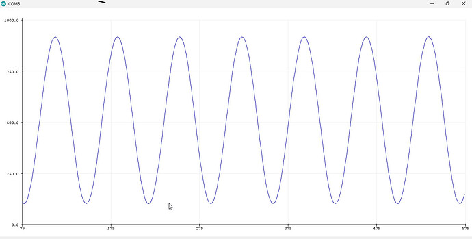

Your code:
This plot appears to show 7 cycles in a time of approximately (500 x 20ms) = 10s.
This corresponds to an 'apparent' frequency of just over 1.4Hz - not the actual 50Hz input frequency. This is the aliasing that John Errington mentions.

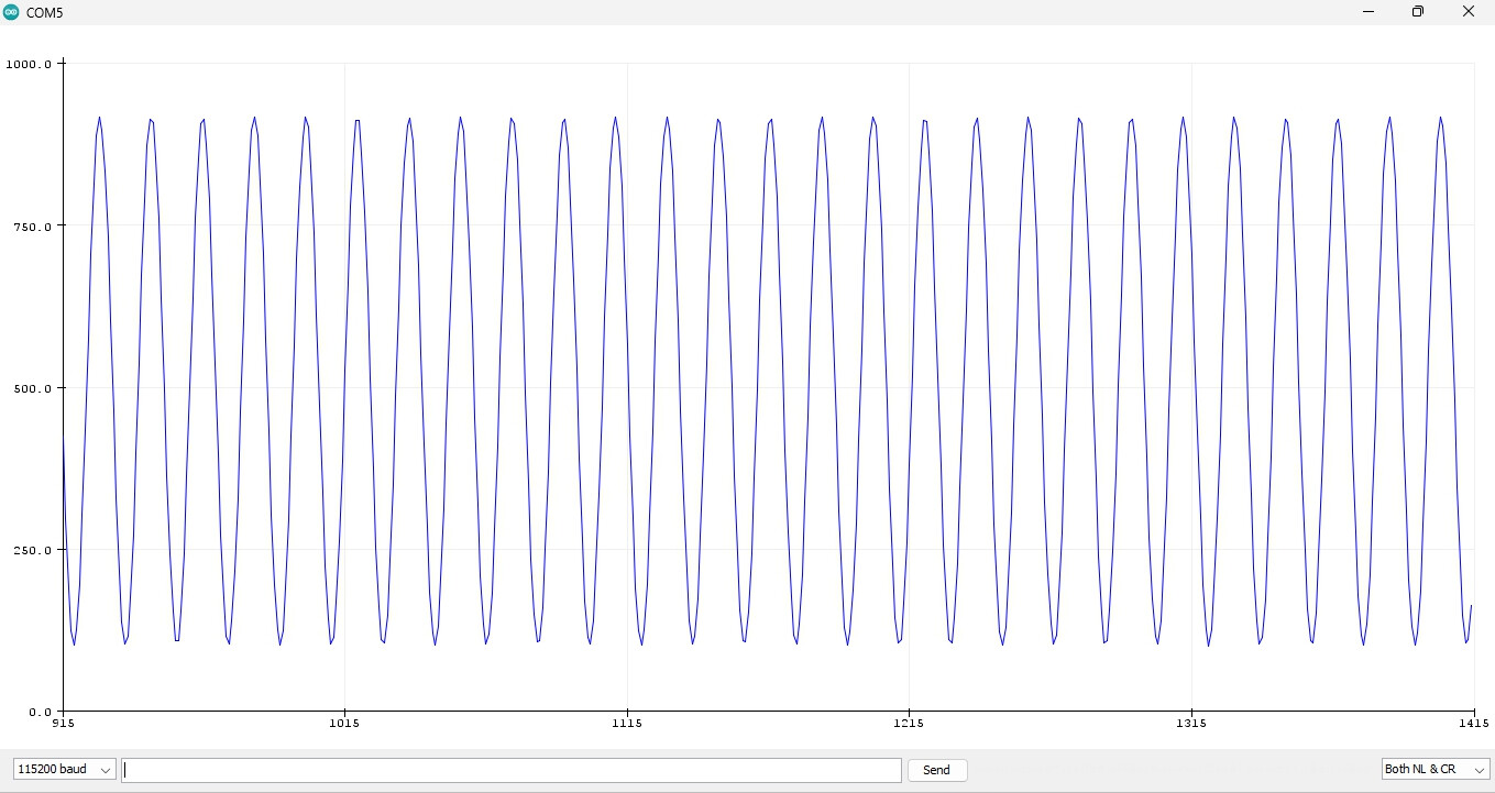

Here is jim-p's code on the Serial Plotter:
The horizontal scale is now different, but correctly displays 27 cycles in just over 540ms.
