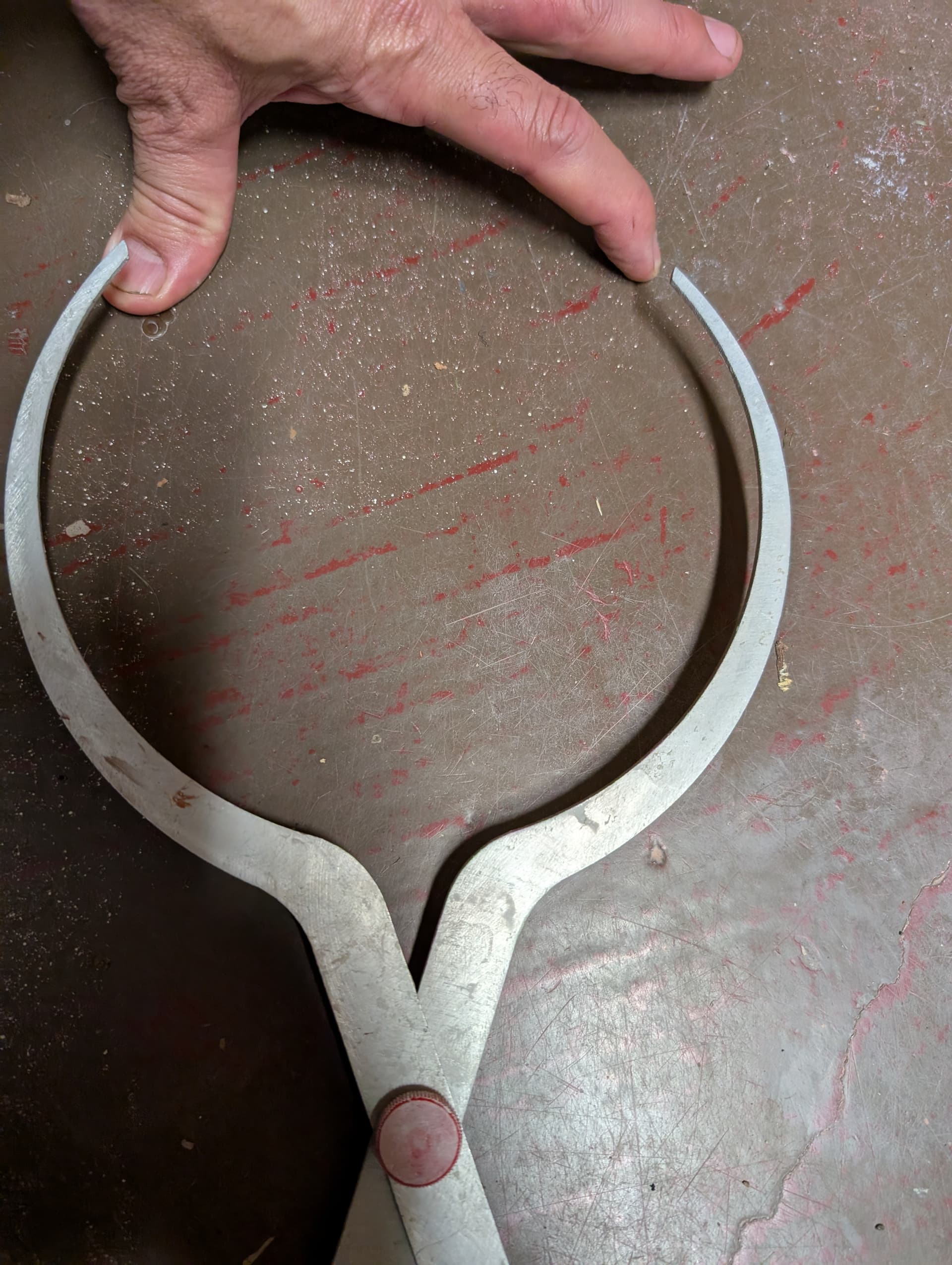

Hello!
I'm looking for a way to measure the distance between the tips of such calipers, or basically the angle between the arms. For the size of calipers and distance measurement I calculated the accuracy of the angle measurement to be at least .11 rad or .64 deg. (Lower is welcome)
I need to have it installed on the caliper obviously so looking for a relatively small form factor.
I assume an encoder would be large for the is application? So maybe some potentiometer or variable capacitor I can read with such accuracy
Any suggestions for such a sensor?
Better if I can get a digital reading directly so I don't need to account for voltage variance etc
Thanks!
Do you know that you can purchase calipers with a digital output?
Yes, I updated added a picture, those angular onesare more hard to find with digital interface I can connect to some Arduino and do some processing
The are some really expensive ones but looks like overkill for what I need - if you know of something like that please let me know

And yes, that's a calculation of the precision I need in distance converted to angle at the axis.
Arm length is 800mm and precision needed is +/- 2.5mm - the translates to the minimal precision I mentioned in degrees

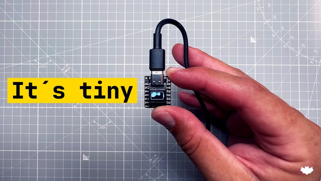

I would use the potentiometer idea, and this display... (and a small mcu)

The handles cross at different points as the arms open or close. They overlap inside of the crossing point. You could measure at the back end, add an arc to a handle to measure how far apart the ends of the handle and leverage a mechanical advantage in the process.
Doesn't look like they allow external read, I need to do real time processing on the data, and also I need to get to about 800mm measurement size, I should have mentioned that earlier
Yes you should.
I'm looking for a continuous read that can process and store as the calipers moves
I did mention I want to read and process the data though.. :slightly_smiling_face:
Yes working out the math is ok, at the end it's a triangle between the points of measurement and the axis. But I need to be able to read the angle
Angles measure radians along arcs. Scale must be curved and attached to one arm. Otherwise like before you do some trig with the triangles, it's up to you.
Is that the range of the one in your photo? It looks extended to about 9 cm. How accessible is an 80 cm target? If you tell us what you're measuring there may be other options. Otherwise +1 to the post #6 idea.
You can use an AS5600 rotation sensor
Has 4096 points per rotation = 360/4096 ~ 0.09° ~ 0.00153 rad accuracy.
Can do hundreds samples per second, might be real time enough, you did not specify how much you need.

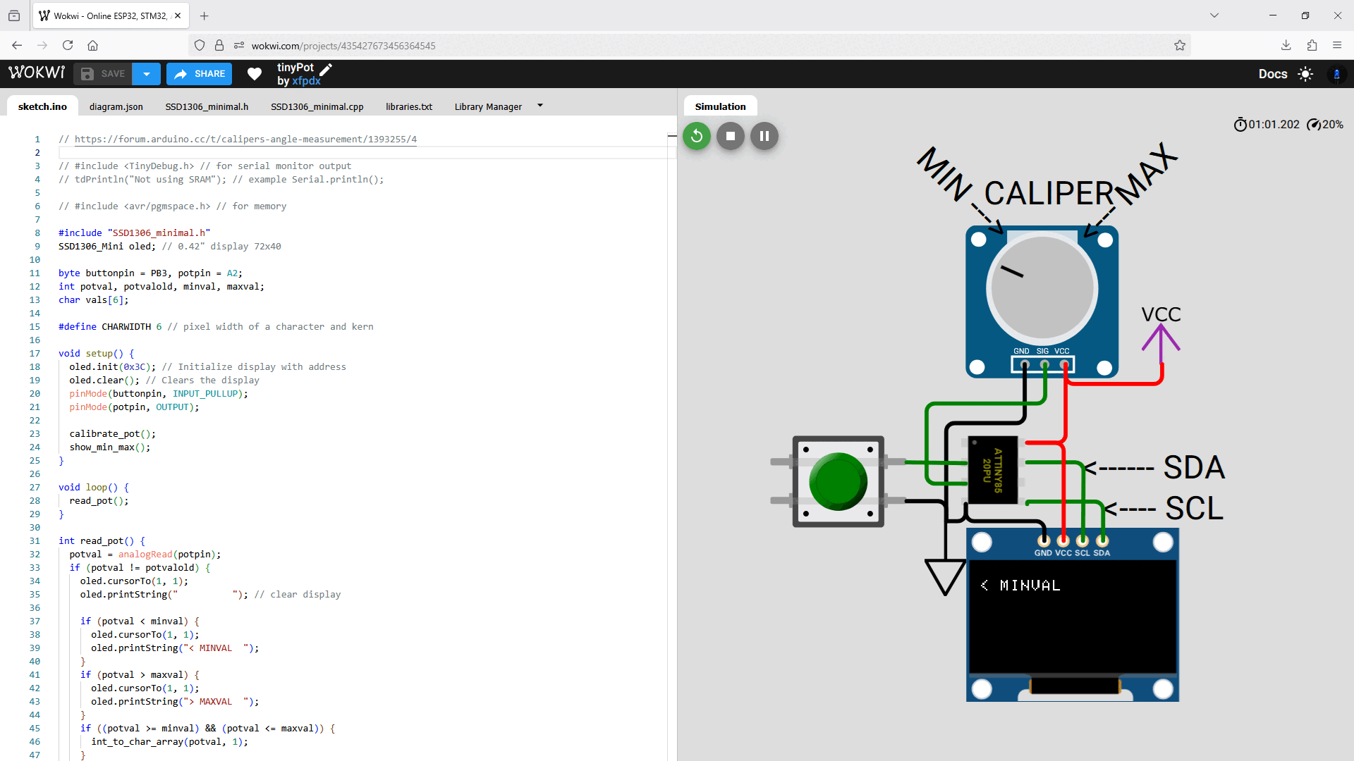

Close the caliper
Make a sample (average multiple readings) to set the zero point.
open it
measure (average multiple readings)
close it
check if zero still is zero ==> or time to (re)calibrate.
Here is this idea in a simulation...

Instructions are:
  • mount potentiometer
  • start tiny85
  • at "SET MIN" close calipers to zero
  • press button to set min
  • at "SET MAX" open calipers to max
  • press button to set max
  • OLED will display current reading
*** oops... forgot to map "min..max" to 00.00 to 100.00
