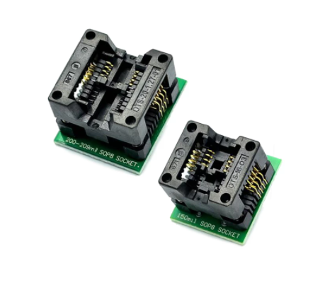

Also, you can buy SOIC to DIP adapters that you can use to program your chip before soldering them on your board

There are adapters that allow the SMD versions to be soldered onto an adapter that then plugs into the breadboard.
Cannot myself see how or why there would be a difference between the DIP and SMT versions, in terms of programming.
Virtually the same within the operating conditions that make sense for a device like this. They're electrically identical; the only difference will be in marginal aspects such as pin-to-pin capacitances which will be slightly different. But you'd have to do some pretty outlandish stuff and operate the device under conditions that are way beyond what's sensible in order to suffer any problems from this.
