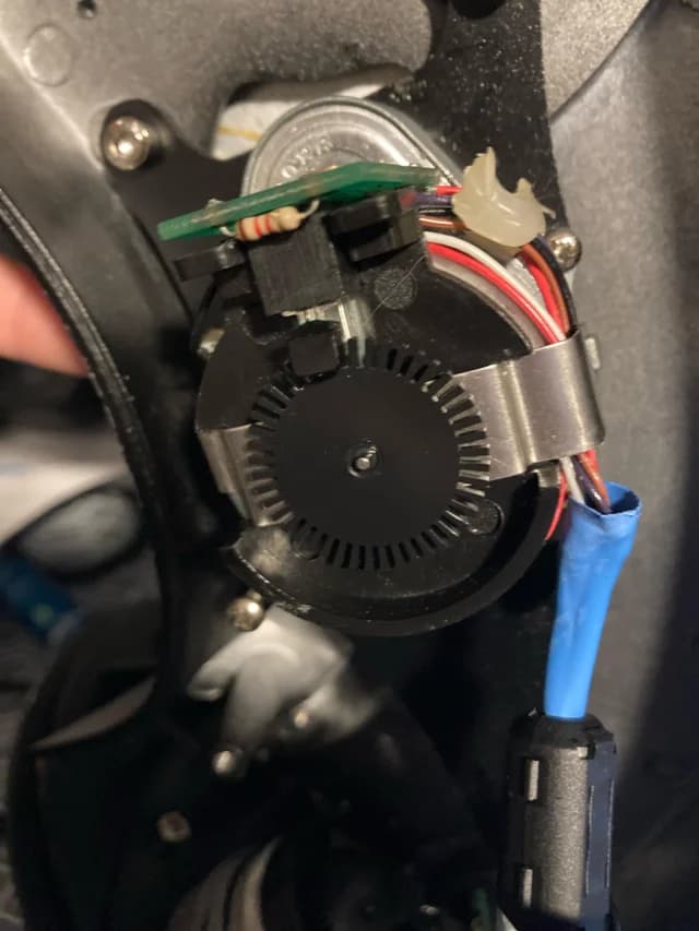

Hi All, I am currently working on fixing/completely remaking the motherboard of a telescope mount, and I am running into trouble with the encoders that are mounted on the motors.
Here's a diagram of how I am hooking it up to my Arduino
So far with that setup, I have not gotten any good results. I have used this code:

And I get this output in the serial monitor when the +5v is connected
23:18:10.606 -> 5 5
and when its not connected
23:18:10.606 -> 0 0
This leads me to believe that the the pins I labeled 3 and 5 of the encoders are always high
another thing I have found interesting is that when I look at the back of the pcb the encoder is mounted on, I see 5 solder points underneath the encoder, but whenever I see images of components that look like the one on the pcb, There are only 4 pins, Am I just doing all this for the wrong component? Thanks a ton for any help you can give me!

There isn't a part number on this, at least not one that gave any results, there is a string of characters but a google search doesn't return anything, I will post that when I have a chance. This is what the encoder looks like though.
Thanks for the help! I have tried a whole bunch of tutorials but all of them just didn't work. I think that I might have the pins messed up
That encoder looks like it is only a quadrature encoder and so will only give you a relative measure of the movement, so for your scope it will have to be calibrated every time it is switched on.
Basically you have two on/off signals that are 90 degrees out of phase. So the first thing to check is if you actually see this when you very slowly turn the motor.
Print out what the state of these two signals are when either one changes. Then you can tell if it works or you have not wired it up correctly.
You can also check these signals with a voltmeter.
Once you get the right signal then you will know what to look for, if not post your results and ask again.
