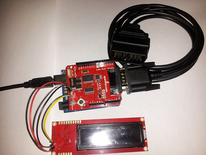

Hey guys i am trying to do this project with the Can-Bus-shield to read the RPM and the speed from a car. I am using the Can Bus from sparkfun with the Arduino Uno, and a SerLCD. I have the can bus shield on top of the Uno and the LCD connect to the Can Bus. No code seems to work i cant even get "Hello World" to the LCD; i am 100% sure with my connections so its gotta be the codes. Can anyone help me please, or any subjection?
Thank you so much!!!
If you take CanBus out of the equation, can you get the display to work? Presumably you have some examples of how to do this.
Show us the code that don't work!
i found this code it is as more then i need, i still couldnt get anything to the LCD.

First: You haven't used code tags, please edit your post and include code tags to make the post readable.
The code you posted is a class library, not a sketch. The library was written for a pre-1.0 IDE version and won't compile as-is on a current IDE. I'm not surprised that a library for itself won't display anything on an LCD, especially if the library doesn't include any LCD code.
To give you a start: http://www.openhardwarehub.com/projects/40-Arduino-CAN-BUS-OBD-Gas-Gauge this is a project, that does use more or less the same hardware components although arranged differently. Nevertheless you should be able to use some of the code.
Supercool:
Yeah, but the word 'Canbus' appears all over the place in that code.
Physically take the Canbus shield off your Arduino, write or find a sketch that just displays on your LCD, and make sure you know how to do that before you add Canbus back into the equation.
