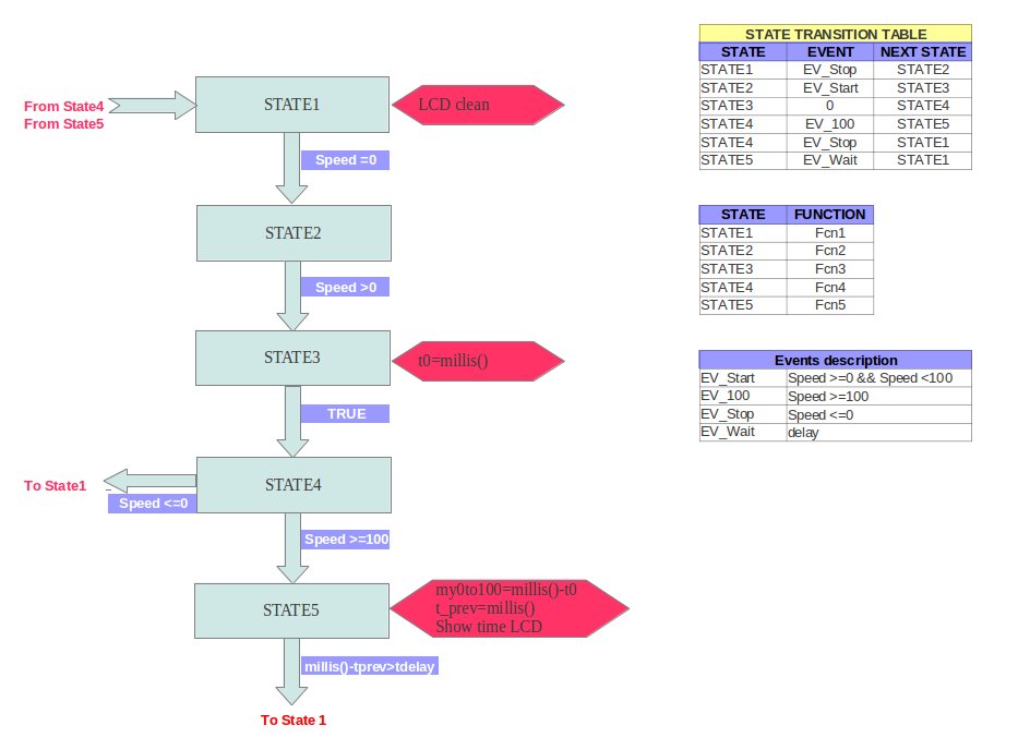

Now, using a basic Finite State Machine's library, we have done this "Chrono Starts".
The test was 0 to 30 kph to avoid go to jail while I was testing the new toy... ![]()
More info => SECUduino: "Chrono Starts": Measure your 0 to 100 kph time
