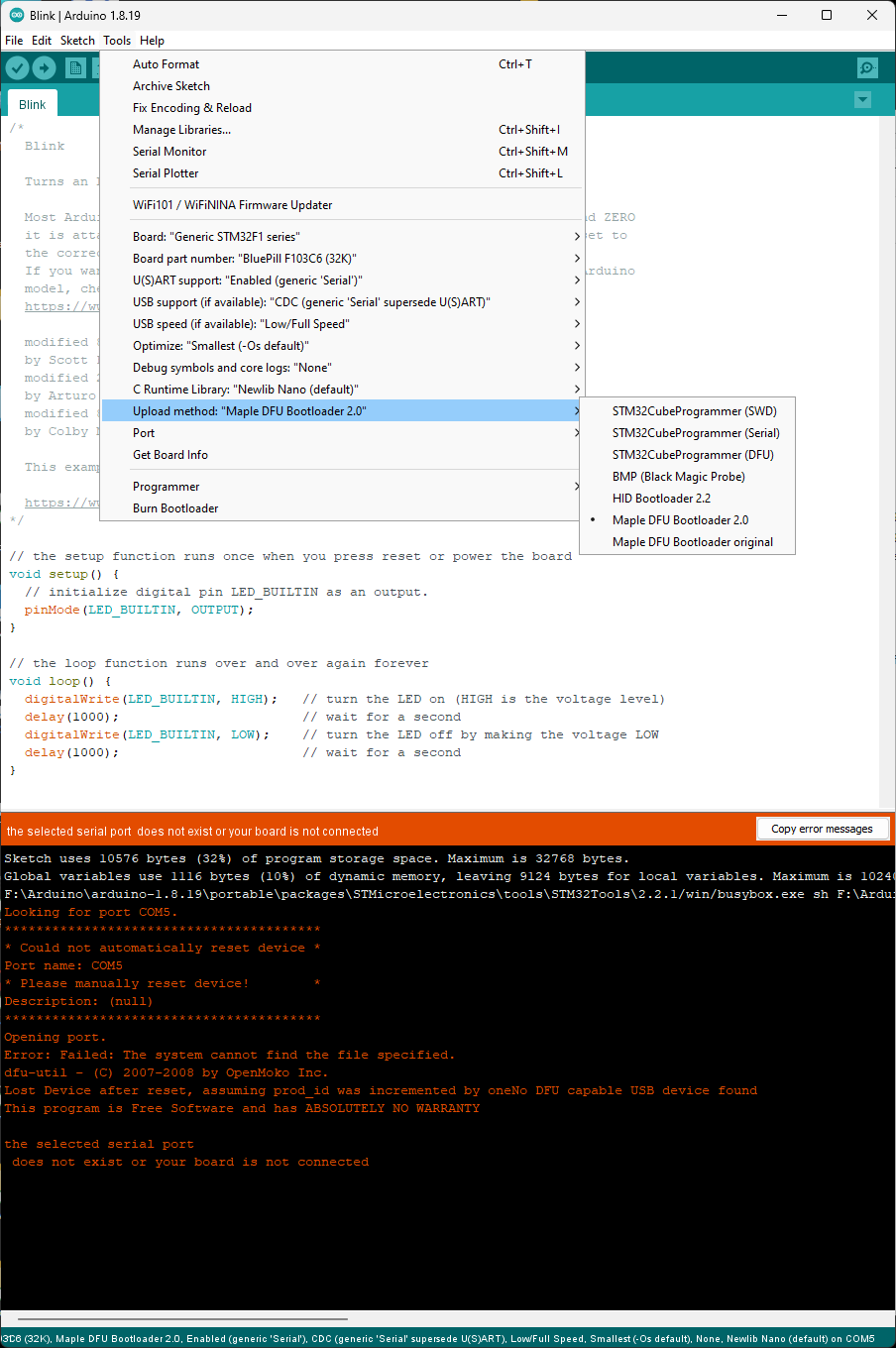

In theory and maybe it can work.
Your Bluepill would have to have a bootloader installed that allows for upload via its USB connector.
The STM32 core for the Arduino IDE supports the Maple DFU bootloader and a HID bootloader.
e.g. for the Maple bootloader this is the upload command the IDE generates on my PC after compiling Blink for the Bluepill
F:Arduino\arduino-1.8.19\portable\packages\STMicroelectronics\tools\STM32Tools\2.2.1/win/busybox.exe sh F:\Arduino\arduino-1.8.19\portable\packages\STMicroelectronics\tools\STM32Tools\2.2.1/maple_upload.sh COM5 2 1EAF:0003 C:\Users\hmeij\AppData\Local\Temp\arduino_build_800861/Blink.ino.bin
The "Blink.inp.bin" is the binary file that gets uploaded. You would have to convert your hexfile in a binfile first.
Personally I find these bootloaders a pain in the neck and strongly recommend to buy a STLINK-V2 USB programmer. They cost about €5,- and will also allow you to upload via the "STM32CubeProgrammer (SWD)" option or even better use the STM32CubeProgrammer software that makes uploading a bin or hexfile easy.
