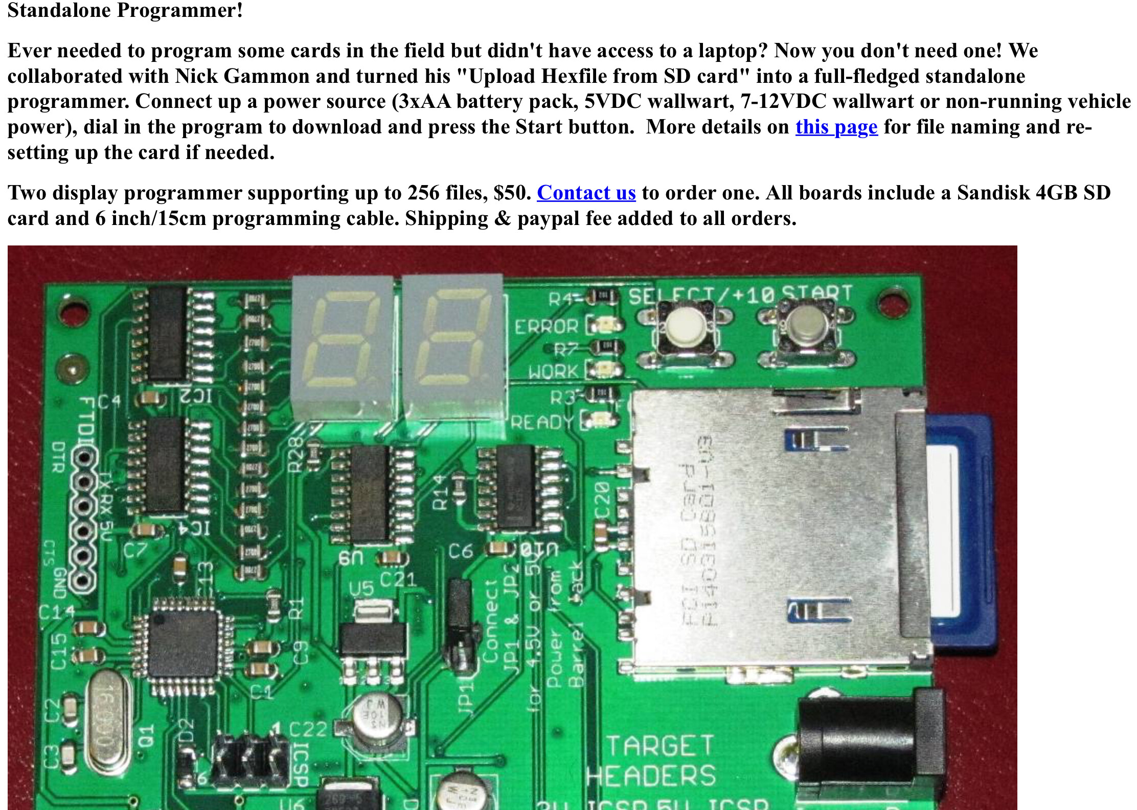

  • You can, sorta.
    If this is still available, here is an option.
http://www.crossroadsfencing.com/BobuinoRev17/
