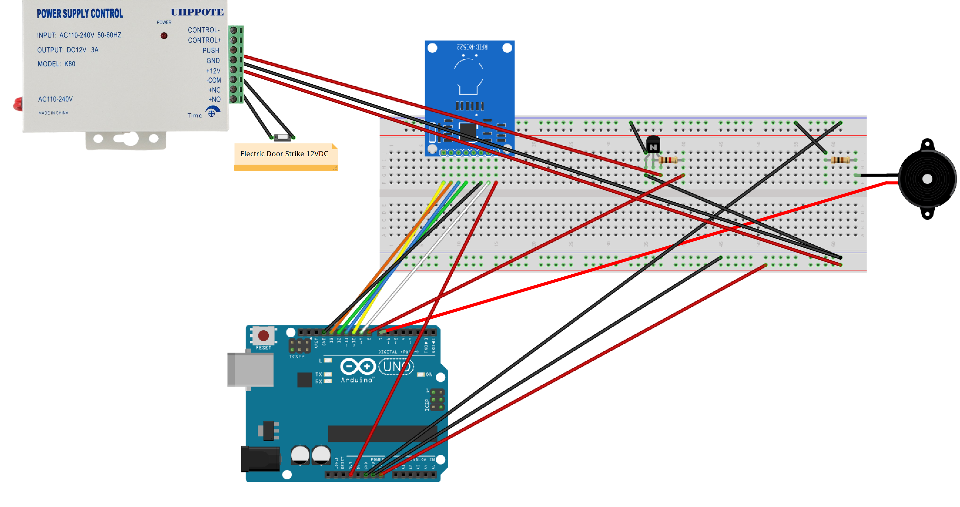

I spent a little time learning Fritzing and was able to re-create my project in this image.
Imgur
I also wanted to include a link to my power supply as it is a little unusual, it’s designed for Door Access control systems.
UHPPOTE Power Supply 110-240VAC to 12VDC for Door Access Control System & Intercom Camera
My main concern with all of this is really stability, this is going into a crawl space near a door and I don’t want it to implode and catch fire for example.
My 2nd concern is trying to keep this stuff small and simple, I was planning on running all of the low voltage wires via Cat6 to the Arduino including 5v/12v supplies into a single/double gang box. (with a 2nd single gang box for high voltage 120vac)
Would it be possible to take a LN7805 for example and feed that directly into the 5v on the Arduino? I don’t think that would be as efficient as a buck converter, but it would be much smaller and I could soldier that to a custom PCB with the transistor for the door strike.
It’s hard for me to judge by looking at pictures of how big these buck converters are, do they make them small enough to fit into a single/double gang box for example?
Thanks again for all the help!
bawitdaba:
Whoops!
You fail to understand the connection here. :astonished: A 7805 dissipates the excess energy as heat. That straight away means it requires a heatsink That makes it much bigger than a switchmode buck regulator.
bawitdaba:
They are quite tiny. Go buy a few on eBay now. :grinning:
Note: Do not attempt to build one yourself.
bawitdaba:
Then you put it in a steel box.
