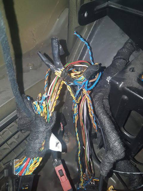

I have some of the cables I think you are referring to. I believe it's copper weld. Some substrate (iron, steel) with a thin copper plating. Mine are even magnetic.

Iām guessing youāre using a gas torch and solder bar? Flux on a brush ?
Carrying solder on a hot iron is exactly the first habit to lose when learning to solder
āTinningā the iron and leads is the second.
I don't disagree but the point I'm labouring to get across is that the OP doesn't need to complete a course to military specs to effectively join a couple of things together; yes, all of these things make for a better job - and yes, learning how to solder is a good investment of time ... but all of that will amount to nothing if the OP (who let's not forget is currently contemplating using electrical tape to make a connection and has already stated that he doesn't have time to learn to solder) gets scared off by all the well meaning but nonetheless anxiety-inducing advice (and attempted "point scoring" & one-upmanship) and choses to continue to put soldering in the too hard basket.
A simple heat bridge and dab of solder is all he needs to learn for now; it's OK to start with that and build better skills over time if they wish.
I'm a big believer in "teach a man to fish and you feed him for a day - but teach him how to fish and you've helped him feed himself for a lifetime"; all too often it seems people really want newbies to become French Chefs when they don't yet know how to boil an egg; and I suspect that often they get so put off by it that they never become French Chefs ... and never learn how to boil an egg either. If so then the advice has done more damage than good.
I also think there's a fine line (not aimed at you) between something that's genuinely helpful and something that more someone trying to start a p*ssing contest under the guise of "it's teaching them good habits so it's for their own good"; but that's probably a discussion better had at a different time and place.
would you say electrical tape works okay?
Only if you are in Thailand where twist and tape is the norm.
