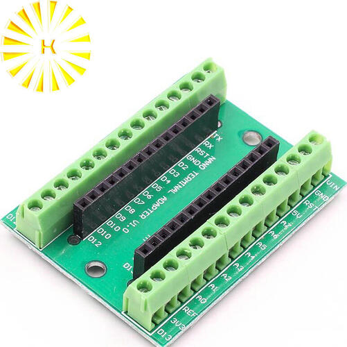

For components with long-enough legs you can sometimes use a screw-terminal block. (This type of terminal block can be cut-down if you need fewer connections in a permanent application.)
(That particular kind can be cut down if you need fewer connections in a permanent assembly.)
