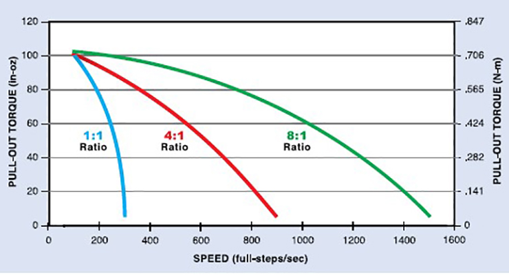

A higher supply voltage (and a stepper driver) means torque won't drop off at higher speeds.
Leo..

Normally the supply voltage is chosen to be high enough to overcome the back EMF from the motor (both inductive and rotational back EMF), and the driver is supplied with this voltage. The faster you want the motor to spin, the higher the voltage.
The current is normally fixed at the nominal level for that motor (to get the best torque/performance from it).
Common stepper drivers for small motors are A4988 and DRV8825.
Common voltages used with steppers are 12V, 24V, 36V, 48V, 60V, 80V or even higher, the higher values being used in high performance CNC machines typically, where fast "rapids" are important. Many uses only 12V or 24V is enough. Note that the supply voltage must be at least several volts higher than the product of motor current and resistance, otherwise the driver chip won't be able to function properly.

I thought I clarified this stating higher voltage were fine and drivers would regulate the current. Increasing the available voltage to the driver decreases the time it takes to reach steady state, increasing the motor’s maximum possible operating speed, operating torque and mechanical power output.
But with increased current comes an increase winding power loss, which increases the temperature of the motor. The motor is also stiffer between steps which can create (audible) vibrations. That can obviously damage the motor. So a trade off needs to be found.
