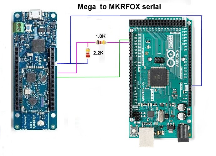

not used a MKR WiFi but have used a MKRFOX connected to a Mega
on the MKRFOX Serial is used for USB communications and Serial1 is a hardware serial port on Tx pin 14 Rx pin 13
the MKR uses 3.3V logic and the Mega 5V therefore a level converter or potential divider is required on the Mega Tx to MKR Rx line, e.g.
also the Serial1 Tx and Rx pins on the MKR WiFi are in a different place - see Arduino-Nano-BLE-Sense-pinout
