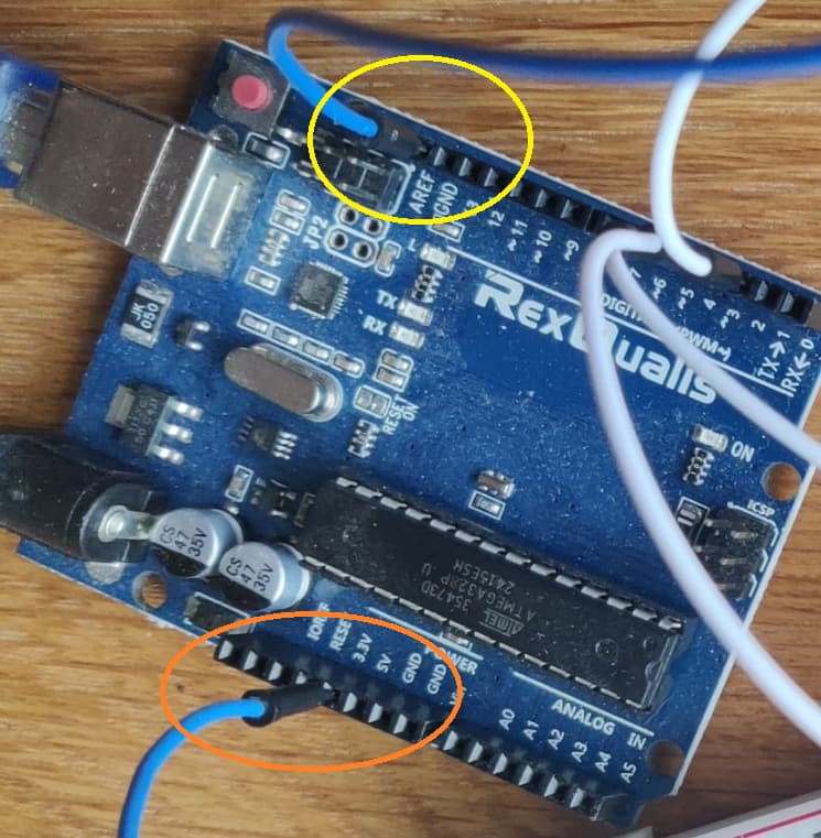

Can someone tell me what I'm doing wrong?
I'm trying to light up the 8 LEDs in order using 74HC595 shift register, but it won't turn on.
The positive rail is on 5V and the negative rail is on GND.

with such a picture we can't tell the Anode from the cathode of the LEDs. Also the spaghettis seems to go to an untold IC...
So the best answer we can provide is that the proverbial crystal ball is still in the dishwasher...
➜ Please do yourself a favor and read How to get the best out of this forum. Post accordingly, including code with code tags, necessary documentation for your request such as your exact circuit and power supply details, links to components, etc.
Closeup shows, I think, positive rail connected to AREF, negative rail connected to 3.3V.
Try positive to 5V, negative to GND.
But I could be wrong.
parallax issue in the picture I think
but indeed best if OP clarified...
