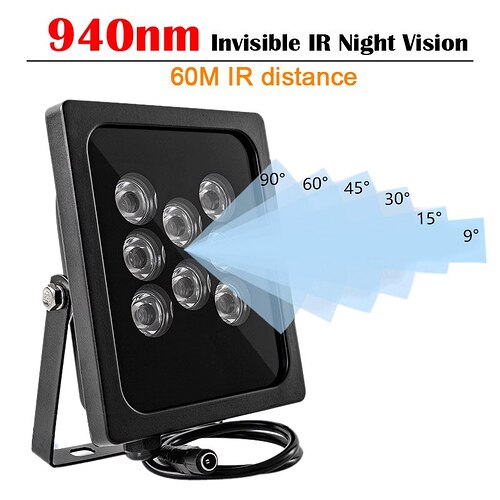

Maybe a weird question but can i use a big IR led for my remote?
For example this one:
Or this one
All these LEDs require of course too many amps to put directly on my remote control, but maybe put a transistor in between?
I want to make this because my remote doesn't work at great distances and i want to make it stronger.
Or do you have a better idea how I can do this?
Thanks!

A T1 3/4 IR LED should be able to be detected easily at 20 feet.
Your IR receiver wavelength must match the IR LED wavelength.
We would need to see the schematic of the two modules you linked before we can supply an answer.
What might that distance be? Our TV remote works at 30 feet or more.
That's not sufficient :frowning:
You may have to get rid of some circuit built into the device, and add your own current control.
You may be happier with 1-2 bare IR power diodes and a transistor and current limiting resistor. For IR remotes the diodes can not have any built-in current control!
Is this a remote that you've built, or are you thinking of modifying an existing remote for your TV or whatever?
There are a lot of possibilities in between the tiny battery-poweredLED in a typical remote, and the multi-watt monster that you linked.
The usual solution is to use several somewhat larger and higher-powered LEDs like you see here: https://www.adafruit.com/product/73

Anyway, depending on how much improvement you need, it might be possible to just replace the IR LED with one that concentrates the power into a narrower beam that will project farther (although you have to be more careful about pointing). But other than that, you would need the schematic for the remote, or at least figure out that part of the circuit that drives the LED, before we could tell whether other changes might be possible.
Of course you can build a remote, but that would be a lot of work, and the final result might not be easy to use. A better option might be to find a "learning" universal remote that has a better range, if you can find one, or possibly find or build an IR repeater that you could install midway.

Just use a narrow beam IR LED (~ 10 degrees) in parallel with the one in the remote.
