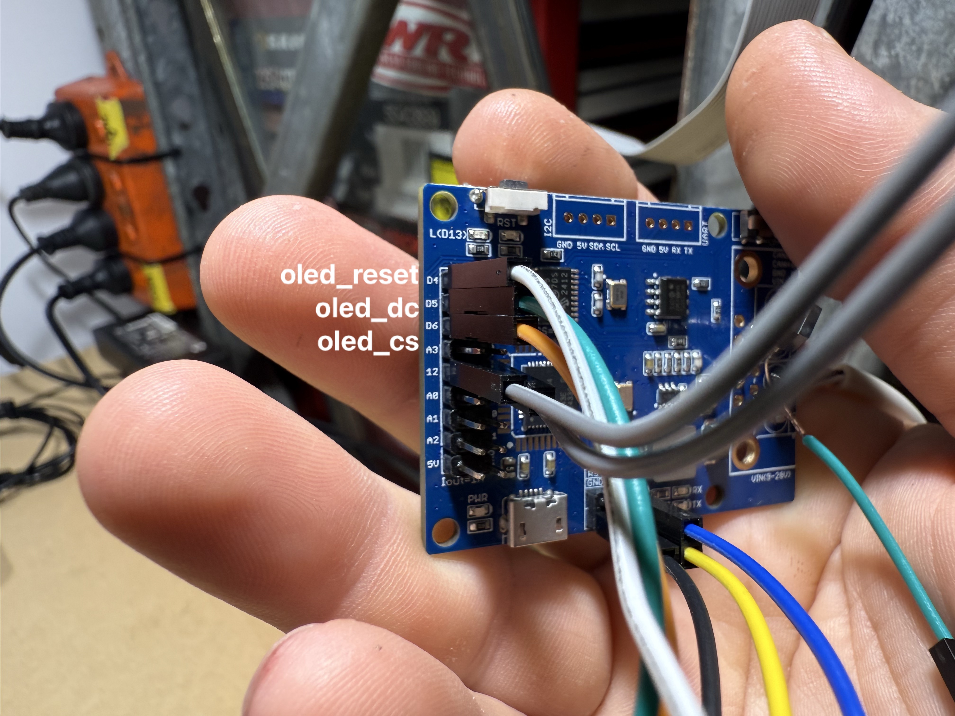

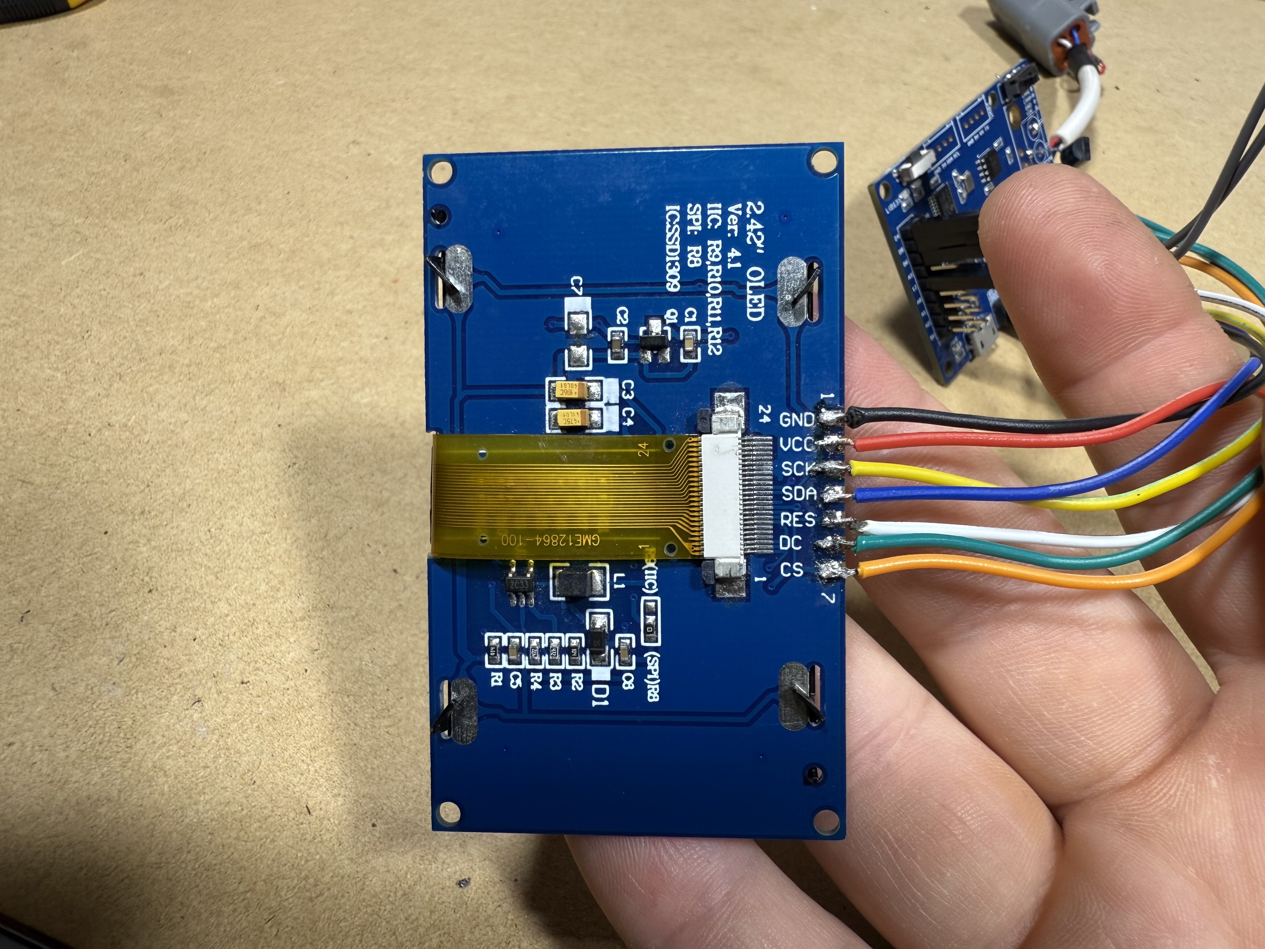

‘Overview: Haltech Elite 750, WB1 controller, CAN Cable plugged into WB1 controller, SSD1306 Screen running with Hardware SPI, CANBED V1 board
Ditched the second hand Hobbytronics board I was using and ended up getting a CANBED V1 board and used a random 2.4” screen I had laying around to get it working
Used a bit of the ELITE GAUGE code as a base to adapt for my setup/use, also adopted an L78L05 to give the screen 5v power as the board wasn’t happy supplying the screen 5v from its ICSP header while also receiving CAN stream (no idea why)
Everything was running swell when I just had ignition on, but it all went to shit when I started the car and the CAN positive went from 12v to 13.9v, Voltage regulator died (weird as it should be able to handle up to 35v input voltage) and killed the screen, presumably killed the board and possibly killed my Wideband Controller as it was sending 7v from the Voltage regulator ground down the CAN ground
Can someone explain what/where I went wrong
Arduino/Coding is the most difficult thing I’ve ever taught myself and I thought I could see light at the end of the tunnel until I let the smoke out of the voltage regulator’
Thanks for reading

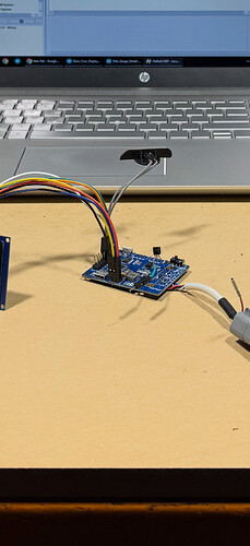

Attached is a photo of my basic setup
‘Rough idea of my setup. When it was all working, I had the red wire from the screen plugged into the green wire coming from the Vo of the Voltage regulator’

The picture is ... well not very revealing. It's like watching a photo of someone and tell what kind of person they are. We need a diagram / schematics. The more detailed the better help you'll get.

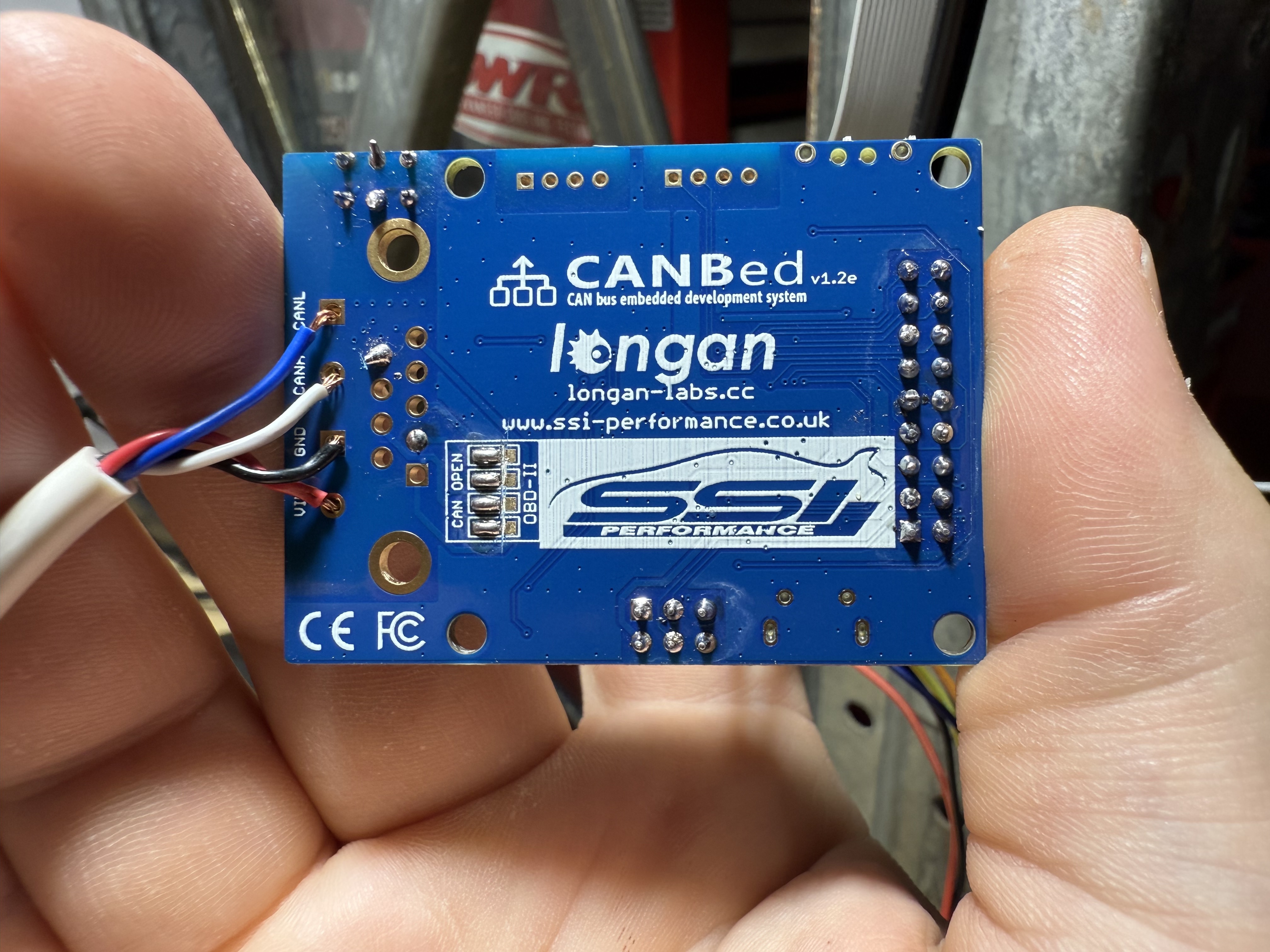

Priority: 1) Schematics reveal the build and components used, 2) photos if something visibly failed, or something was connected wrong.

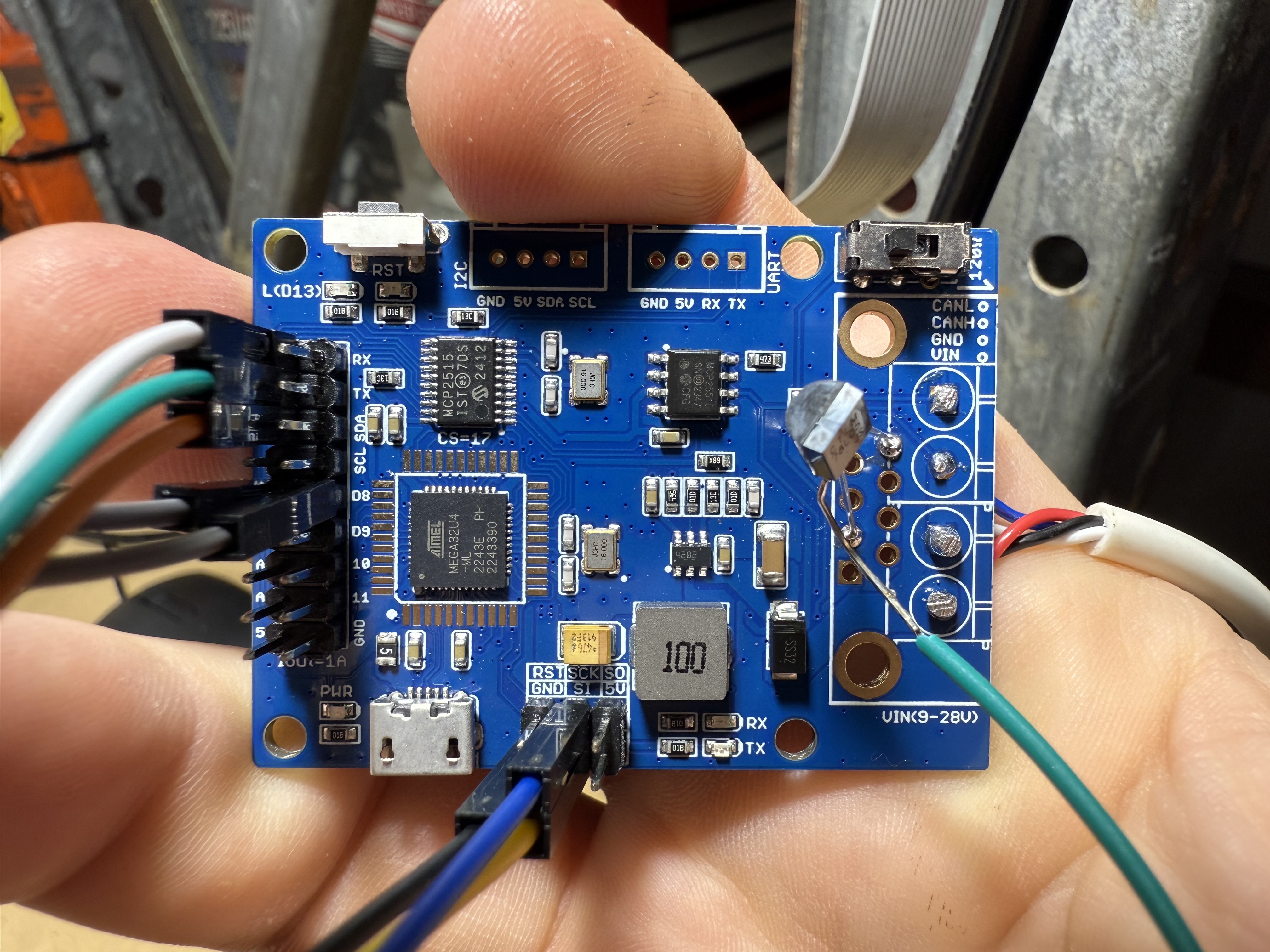

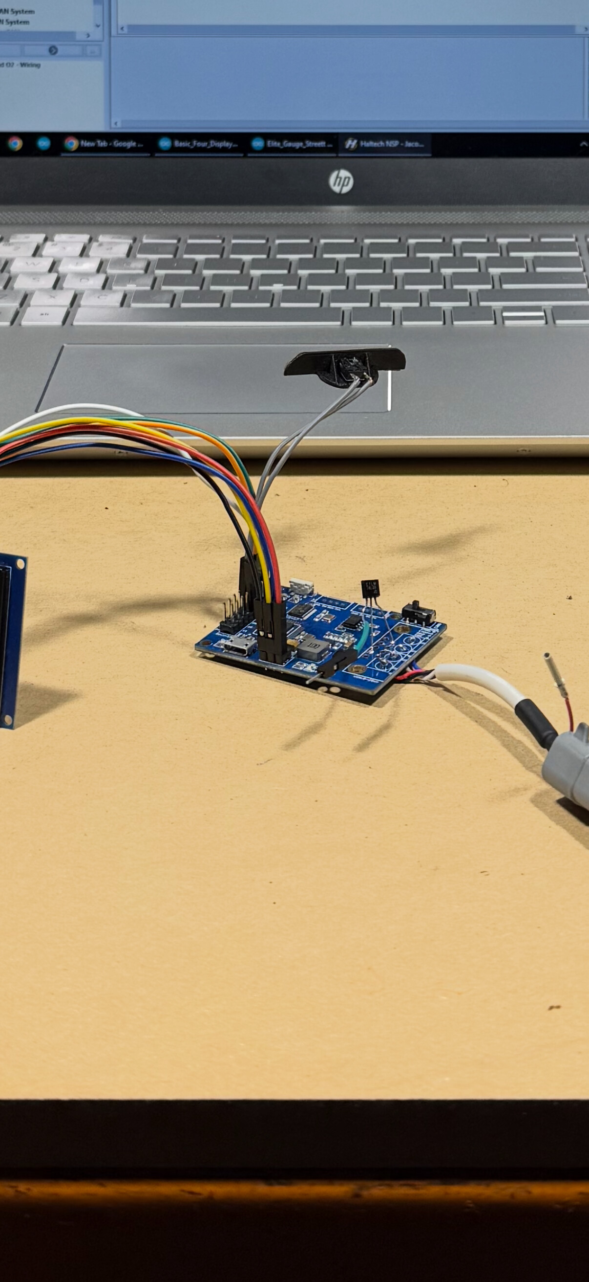

Hopefully quality/resolution of these photos is fine
Mind the soldering job, was using this board as a proof of concept board
Not pictured is the rest of the setup in my car, uneventful in regards to this setup, links in with a half metre-ish cable with a DTM4 connector

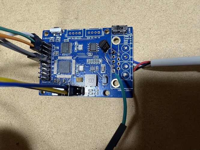

Didn’t realise new users could only upload three at a time, here’s the final three
They are, but still nothing compares to a proper schematics.

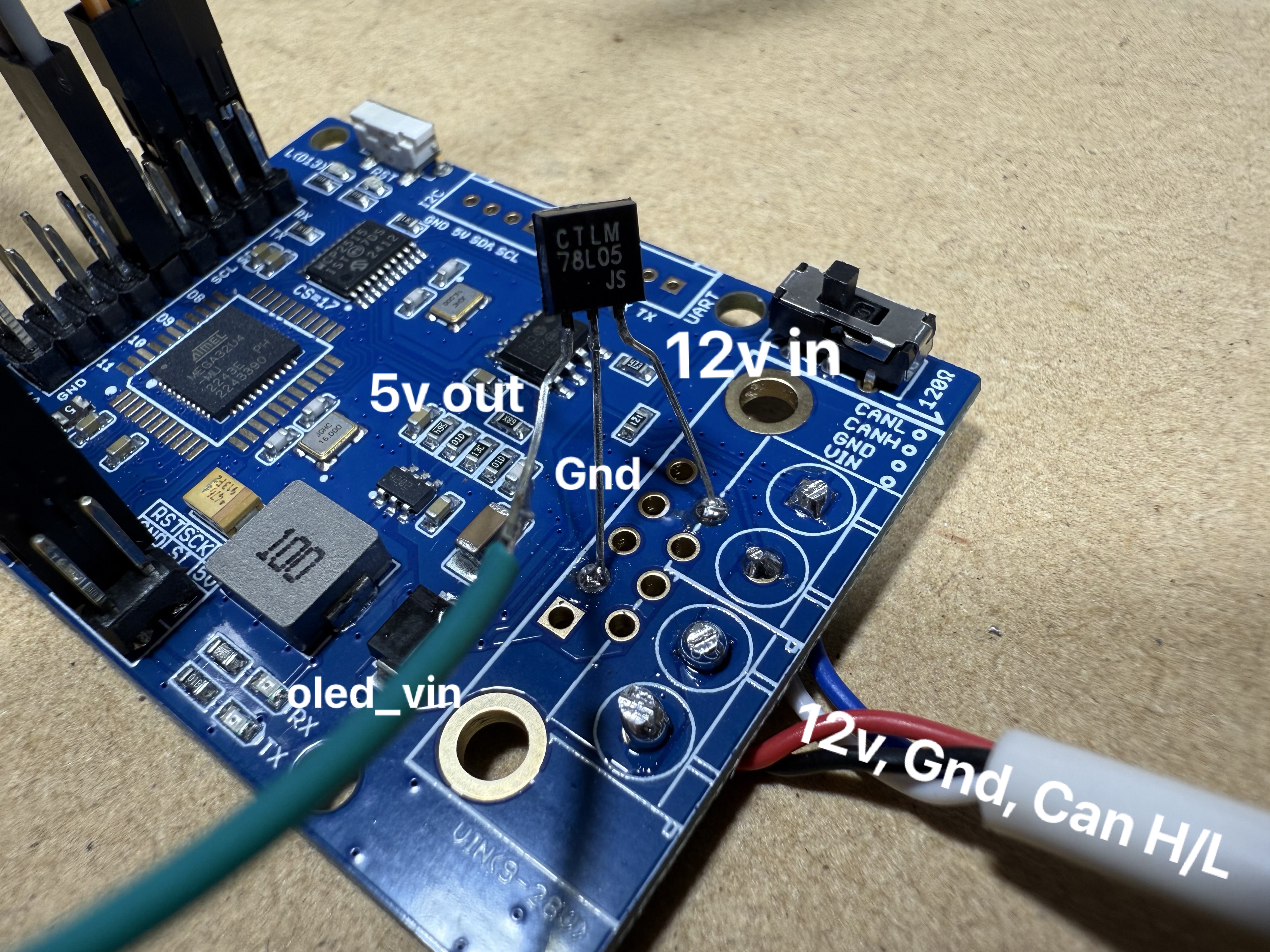

That 3 legged transistor-look-a-like is the regulator I assume. Does it power everything 5 V or is there some other regulator?
Btw do you got a link to the datasheet?
I can’t find a true schematic unfortunately, closest thing is this
Datasheet for Voltage regulator is here
The three legged regulator only powers the screen, there is an onboard regulator somewhere that brings the 12v from CAN down to 5v for the board to operate

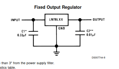

So that's the regulator that malfunctioned. I guess it shorted and 12 V or more went berserk. There's a very likely reason to this: I don't see any caps accompanying the regulator. This is from the datasheet.
Running voltage regulators without capacitors can make them oscillate, and that will stress them. I would in addition to C1 add an electrolyte rated 63 V before C1, maybe a Zener too, as an increased protection against voltage spikes.

Having a quick google now, what uF should I be aiming for, and how would I arrange the setup if I was to incorporate a zener diode as well as a capacitor for the screens voltage regulator?
The other board that had a L78L05 wired in the same way didn’t have any of this additional hardware so I’m unsure

This is an suggestion, nothing else. But it will give you much better chance of keep the circuit healthy :slight_smile:
I skipped the Zener to keep it simple.
To be added: The Farad value for C1 are not set in stone.
C1 is an electrolyte
C2 C3 are ceramics

What does the manufacturers data sheet say, not all 7805s will live with 35V on the input. This one will take only 30V. https://siliconsupplies.com/media/literature/ss/78L05%20REV%202.pdf I have seen some as low as 21V.

Great, what protects the regulator from getting voltages over 35V. Read the first page of this app note and look at the lower right hand corner. https://www.ti.com/lit/ab/snoaaa1/snoaaa1.pdf? There are also negative transients that you need to protect from. Spend the time and read the links I posted previously.
