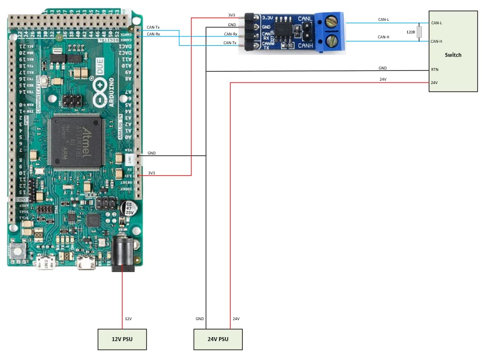

I can see a lot of possible problems. Post an annotated schematic showing exactly how you have connected everything. Be sure to show all components, connections, power sources, grounds etc.
I have no clue as to what your hardware device is or if it can respond with its ID. Post links to its technical information.
Hello gilshultz,
Please see attached the schematic diagram of the Due, CAN breakout board, switch and wiring.
This switch has previously worked on an old PC system (windows xp), so I know the *IDN? command works with the switch. However the PC systems is long gone and I am trying to replicate the system with the attached schematic.
I am struggling to get any response from the switch (no datasheet available, but I am assured the 4 wire interface is correct), and I just require confirmation the code and schematic will enable the switch to operate correctly?
