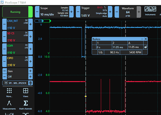

Below is the first code I tested.
This one opens the dataFile for each main loop.
Which leads to a normal write cycle at about 21ms, since I intend to use this for a RC servo signal (50Hz) sent over CANBus, I need a write cycle far less than 20ms.
Using the SD library.

The next code, dataFile are opened at setup and kept open as the main loop runs.
Resulting in a normal write cycle at about 11ms.

This might be acceptable, but I could not refrain from tuning it further.
The next code, at setup tries to find the fastest frequency the SD card will accept.
Normal write cycle at about 8.51ms.
Here then CAN messages are put into a struct and written binary to a file.
Even though it is not proven here in this post, this has little practical effect on the write time.
