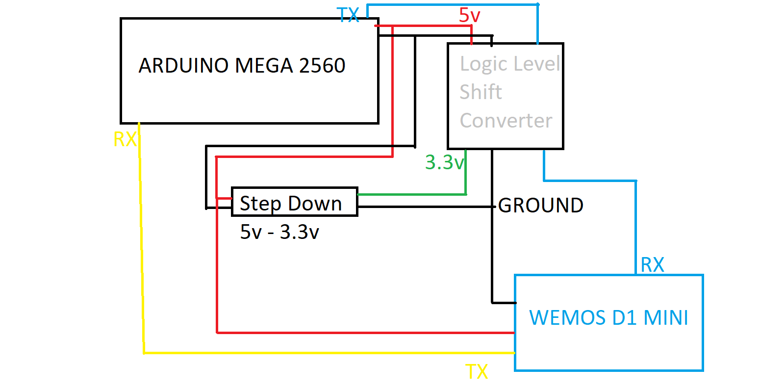

Hello,
Recently i have been having a programming problem with my Arduino Mega 2560.
I have connected a Wemos D1 Mini to an Arduino Mega 2560 via the 2nd Serial port on the mega.
MEGA/WEMOS
TX (pin 16) / Logic Level Shift Converter / RX
RX (pin 17) /TX
5v/5v (It is stepped down on the Wemos)
Gnd/Gnd

Attached is the way it is connected

Also here is a labeled diagram

Please draw (with a pencil or pen) a diagram showing how you have everything connected with clear labels on all the connections and post a photo of the drawing.
My suspicion is that you have wrong connections to the converter - but I can't be certain with your Fritzing diagrams.
...R
Dont mind my awful paint schematics.
I forgot to include the regulator i had in the last drawings.
I tried to make sure everything had a common ground.
Also just changed Wemos to run off a 9600 baud rate.
Thanks for the help
I know I probably seem like a PITA, but you have not shown the labels on all the pins on the level converter - and that is what I really need to see now - so I can compare it with the online info about the device.
And what is the "step-down" thing that was not shown at all in your earlier diagrams.
Is the diagram in Reply #13 complete? Or are there other parts or other connecting wires that you have not shown?

No, i just cant easily describe the pinouts.
I have added pictures to the same or similar devices to better show how its connected
Also as shown in the first post,
MEGA TX = 16
MEGA RX = 17
WEMOS TX = GPIO1
WEMOS RX = GPIO 3
I added the step down to deal with the current draw rather than having it directly plugged into the arduino.
Thanks.
Thank you for the better diagram. It would be nice if we could find a proper instruction document for the logic converter. As it is all I can do is guess - so I may be wrong.
I thought I had a sensible guess, but when I re-considered it did not seem sensible.
Sorry, I don't know how the thing works or whether you are using it correctly.
Why not replace it with a pair of resistors wired as a voltage divider - like this
   (5v Tx) ----- 3300ohm ----------- 5600ohm --------(GND)
                         (3.3v Rx)
...R

I found a datasheet on the similar model:
For some reason, all of these models are discontinued. Maybe it dosent work?

Those resistor values should work fine.
If the system is not working with them then there is another problem.
Can you write programs for both the Arduino and the Wemos so that you can test one-way communication in both directions - maybe everything works in one direction but not the other?
