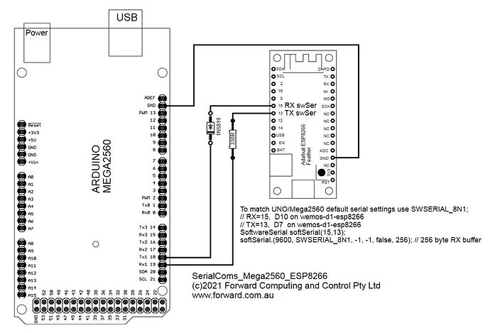

First try one of my complete sample sketches and circuits for Serial Coms between Arduino/ESP
If you are using a Mega then use one of the hardware serials instead of Software Serial (although I have sketches the work for SoftwareSerial as well)
You could start with Uno-SoftwareSerial to ESP8266-SoftwareSerial
Then replace the UNO-SoftwareSerial with Mega SerialComsPair_HardwareSerial1.ino.
Not one side must be set as the Controller, you will need to set the Mega as the Controller, see the tutorial for details.
I am currently working on a much simpler set of code for this so watch that page for updates.

Please provide a connection diagram

Using swSerial on pins 0 & 1 (GPIO nrs) is not going to work very well, since GPIO1 is the hwTX pin.
I would not use swSerial at all on the wemos side, but rather use swap() to switch to the alternate pins for hwSerial (13 & 15)
Remember you will need a voltage divider on to divide the incoming voltage on the Wemos RX pin.

Your swSerial in the ESP code is never even started, but then again you never seem to be reading from it, but your hwSerial is used for passing information to the user.

I managed to get some code working using my revised SerialComs class.
Currently I have the code running between ESP32 Serial2 and Mega2560 Serial1.
Since you are using a Mega on one side, any reason you cannot use the HardwareSerial Serial1,2 or 3 instead of the SoftwareSerial?
I will have look at setting the code up on ESP8266 tomorrow,
in the mean time here is some output

Since you are only sending in one direction it may be simpler to just add unique start and end chars.
Like < > to the json output and then use
code like startEndCharInput.ino
see Arduino Software Solutions
So start with stripping out the web stuff and just get the json to go from board to board.
Edit: - On second thought not that easy due to the delays on both sides and the RX buffer overflow problem. You need a small sync char the gets things lined up, which is what SerialComs does. It uses \n (empty line) as a sync

Hi jelka_bisa try this out and see how you get on.
Here is the circuit I used.
Download V4.1.0 of the SafeString library from the SafeString tutorial
Here are the two sketches I used for testing. I removed all the web code and sample averaging.
The ESP8266 did not like having the static json processor in the loop(), so I made it global and reduced the size.
The ESP8266 SoftwareSerial is set up with a 256byte RX buffer. Because of the long delays in both loops, the RX buffer needs to be able to hold the entire json message. The current json msg length is <100 chars so there is plenty of room the add more. I increased the baud rate to 9600. Comments on-line suggest upto 115200 is OK, but I did not try any faster than 9600.
A note about
SafeString::setOutput(Serial);
That statement enables SafeString error msgs and debugging. You can comment it out once you are clear everything is working.
