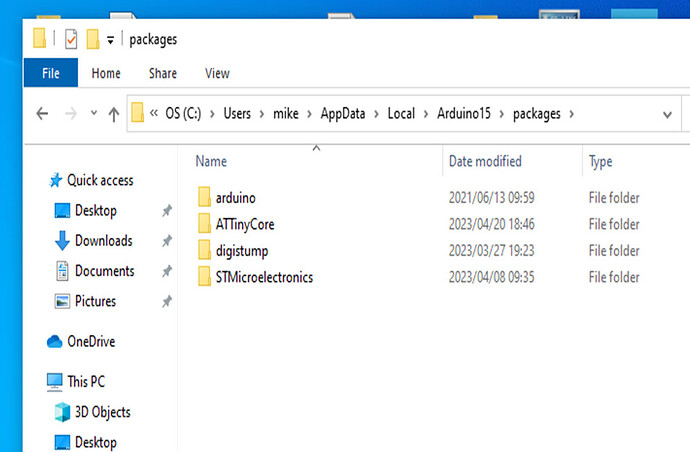

You must install it into a very specific location under that folder. Arduino15/hardware is not the correct location.

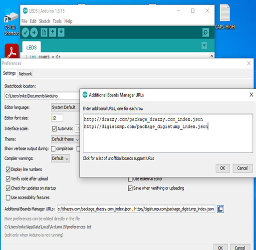

Something you should note is that Arduino IDE 1.8.19 only recognizes "cores" that are installed under the Arduino15 folder when the "Additional Boards Manager URL" for that "core" is present in the "Additional Boards Manager URLs" field of the Arduino IDE "Preferences" dialog. Even if you have the "core" installed in the correct location under Arduino15, it won't show up in the Tools > Board menu of Arduino IDE without the correct URL in the preferences.
You can add multiple URLs to your preferences by separating them with commas:
http://digistump.com/package_digistump_index.json,http://drazzy.com/package_drazzy.com_index.json

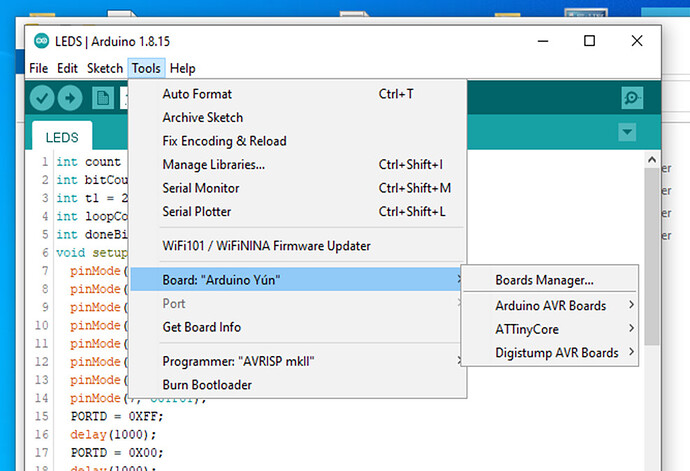

The last one I install is alwys the only one that I can see , because the URL Link is still in the Preference dialog.
I will test this later and report back.
I have both URL,s in the preference dialog but only the last Core that I installed shows up in the Board selection.
Both Cores is installed with the Board Manager.
This is the path of the installed Cores.
Something I didn't mention is that you also need to open the Arduino IDE Boards Manager once while those URLs are in your preferences. This causes the JSON file that is the target of the URL to be downloaded to your computer.
Try this:
  1. Select Tools > Board > Boards Manager from the Arduino IDE menus.
    A "Boards Manager" dialog will appear.
  2. Wait for the updates to finish, as shown by the messages printed at the bottom of the "Boards Manager" dialog.
  3. Click the Close button on the "Boards Manager" dialog.
After performing those instructions, check to see whether both "cores" are shown under the Tools > Board menu in Arduino IDE. Hopefully all will be well now.
The tricks of the trade.
I followed your steps and yes now both Cores is available.
Thanks a lot.
