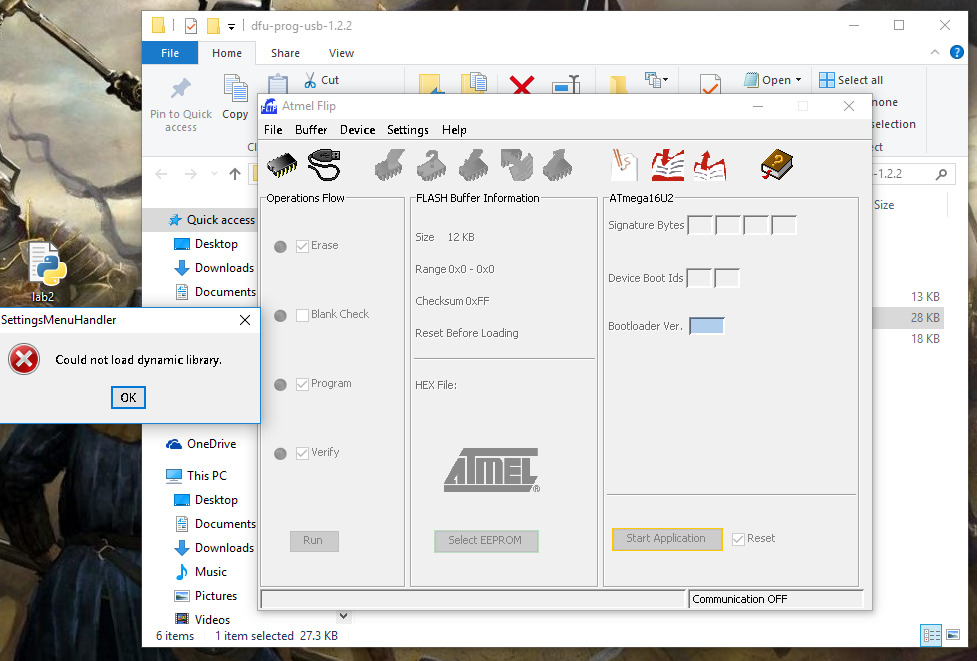

Aditionally I have tried to use Atmel's FLIP, but it cannot find a .dll file (pictures of what I mean attached).
I have tried to fix the error as per Solution - Flip error "AtLibUsbDfu.dll not found" when flashing Arduino - YouTube video, but I get the following error message:
Cant help you with FLIP.
However that last pic looks like you are trying to tell your computer to use a driver it does not like.
You could disable driver signing and see if that helps but I am of a mind to think that's not the whole issue.
Are you doing these steps with everything disconnected from your board ?
I played with unojoy and even tho installed flip all I had to do was :-
Plug in your board.
Short the two pins , then when computer beeps then click on the "turn into a joystick.bat" file in the unojoy folder.
Hope this helps.
