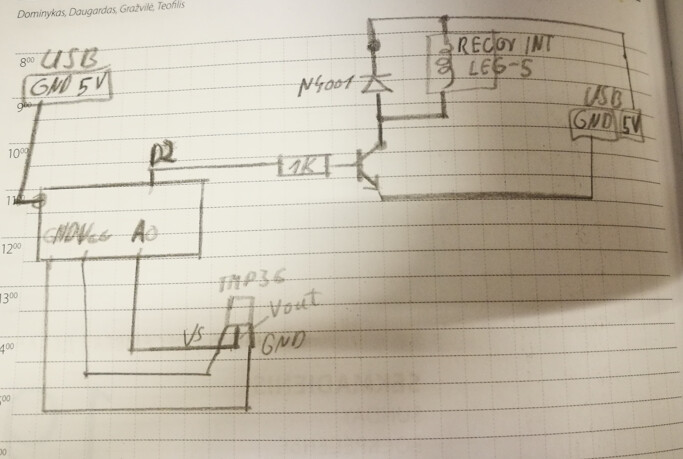

Hello,
I'm trying activate 5V relay using Arduino which is sending signal when TMP36 sensor is reaching certain temperature. Since it can't be activated through digital output directly i'm using a circuit as shown below (except I have 4001 diode)
I've connected everything, first tested with LED where the relay should be, it lights up as intended. When I put relay, nothing happens.
I've measure how much current the relay draws, it was around 20mA.
Then I tried to measure current when I give voltage directly from 5V output of arduino - 60mA.
As I understand the 2n2222 when activated connects relay leg to the ground while 5V is connected directly to other relay leg. So it should work the same as connecting directly to 5V and GND. 2N222 has rated current as 800mA maximum, so that shouldn't be a problem as well.
I'm new to Arduino and don't know what i'm doing wrong. Does anyone have any insights?

Hi, I'm sorry for the confusion, the relay is connected directly with wires as you can see in the picture above (it does not let me to make a post with multiple pictures). I just used this layout and missed the fact that it is shorted here.
And the relay itself is this one:
I've measured the resistance of the coil, it is 72ohm.
So in this case i'll stick to transistor since 5/72 = 0,069 A (even more current)

Hello,
Finally had time to get back to this project :smiley:
here is the hand drawn schematic (hope it is clear).
Also there was a mistake at the code, therefore it was not printing
