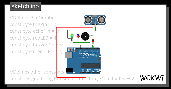

See it run in WOKWI: distance alarm - Wokwi ESP32, STM32, Arduino Simulator.
Clicking on the sensor in run mode brings up a slider to vary distance.
OP is using this variable as a flag to decide if it's the first time he enters in the else - then this is where he is acquiring the start value of millis which will be not null (it will kinda fail only if he is unlucky and millis() rolled over and is at 0 )
here is an example using a state machine and not polling the sensor too often
I added a buzzer which gives you an audio clue when the operator can slide in the next part. The buzzer will also emit a sound if a new part is positioned too early.
The serial monitor gives clues on what's going on
hopefully the state machine is pretty trivial to follow
click to see the code

Nice!
