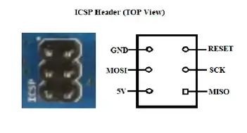

I'm trying to burn the bootloader on my mega 2560 using an AVR ISP but it was just stuck at burning bootloader.
at first i suspected it was wrong connections since i came across two different pinouts so i tried to use the pinout in the second image but i got an error, and when i switched back i got the same error. i tried switching com ports but it didnt work.

I think it looks like some other piece of software is using your COM3 port.
Make sure that COM3 is infact the right device, then go hunting for any other running software that might be opening COMs.
Restart your computer if you didn't already.
I've also fixed strange errors like this before by opening the COM device in device manager, and manually assigning a much higher port (COM20?)

Restarting my laptop got rid of the error message, but it was stuck on burning bootloader again. I changed the COM port to 15, but then I got the error which I have already pasted so I changed it back to 3 again and got the error again. So i restarted my laptop yet again and now I am stuck on burning bootloader again.

there is no error cause there is no output
Alright guys, apparently the ATMega 2560 is busted
