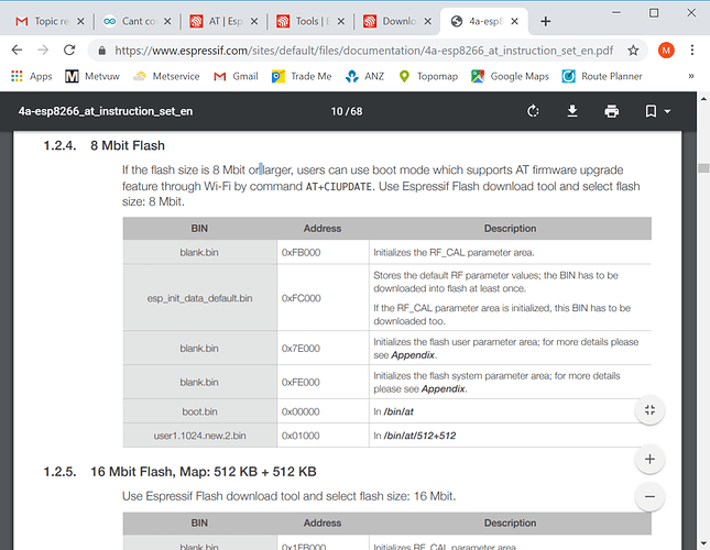

the addresses for 1 MB flash of the esp-01 are in chapter 1.2.4 of the AT firmware reference
Download Overview | Espressif Systems

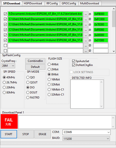

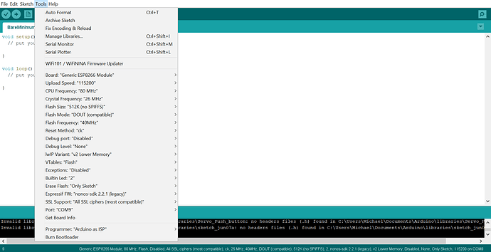

Right so I followed your instructions and it ended up saying com fail on the flash tool and and error message. Here are screen shots of the settings and results. Thanks for being patient with me.
Cheers
Forgot to add that I connected the gpio0 to ground then unplugged the ch_pd pin and plugged it back in to reset it in flash mode like you said.... and im pretty sure I did everything else right.
And there was 2 options for the esp_init_data_default_v08.bin file so I tried that one and the esp_init_data_default_v05.bin file as well. The pictures are when I used the v05.bin file.
did you close the Serial Monitor?
Yes it wouldn let me start it unless I closed it. Are all my settings correct on the flash tool and my esp on the arduino ide?
