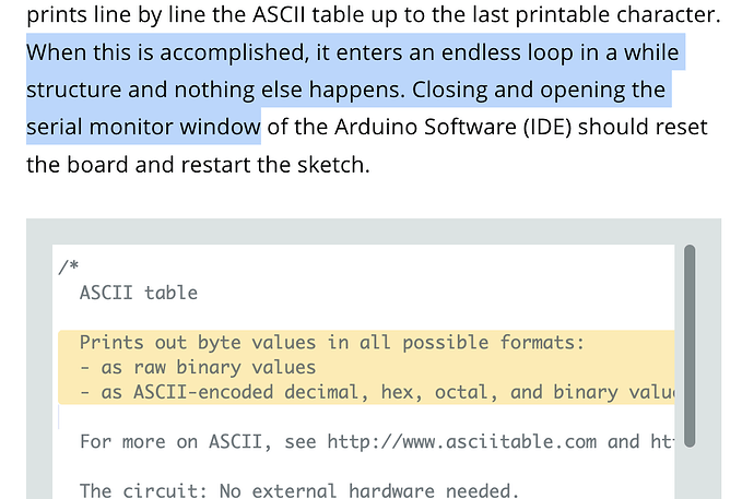

Can't copy code from Arduino example pages
Copying code from the example sites does not seem to work.
For example from
If I select this setup code in the code box and try to copy it:
all I get is one line:
  //Initialize serial and wait for port to open:
If I select all the code, I can only copy and paste one line:
On that page, the output box has a copy icon and it works:

I would expect that all the code is copied. It's a pain because I like to refer folks to bit from the official tutorials, and I can't copy the code form there.
It would also be nice if the examples had a code-copy-icon like the code chunks in the forum do.
I'm using a Mac with Chrome, in case that is an issue.
It looks like this is not simple text, but something inside of a JavaScript app or something of the sort.
On my system (Linux / Debian sid) using Firefox, the code can be copied by using CTRL-C after highlighting it and it can be pasted using CTRL-V (or CTRL-SHIFT-V in a terminal). The standard paste using the middle mouse button does nothing.
I hope this helps.

Nope. Just the text I pasted in the boxes:
Neither of them is a long line w/o carriage returns.
Nope. crtl-c on the code box, and then ctrl-v here acted as if I hadn't pressed ctrl-c, and ctrl-v pasted the stuff from an older copy&paste.
My normal mac copy-paste command is command-C and command-V and it works for the non-code text on those pages.
Also, if instead of the hotkeys, I try the Chrome edit commands from the window menu, Edit/Copy and Edit/Paste, then the Edit/Copy command appears to not update the clipboard with the code, and the Edit/Paste pastes the text from the immediately previous copy.
What about Highlight/right-click ?
All the other stuff on the page copies and pastes as normal.
I think that the code inside this iframe/scrolling/code box is managed by Javascript and handles highlighting and copy/paste differently than the rest of the page.
<textarea class="ace_text-input" wrap="off" autocorrect="off" autocapitalize="off" spellcheck="false" style="z-index: 100000; text-indent: -226.223px; transform: translate(199px, 116px); height: 1px; width: 1px;" readonly=""></textarea>
Nope. Highlighting + rightClick+Copy is as if I didn't click on Copy. A subsequent paste just gets me the previously copied text.
I noticed that the highlighting in the box is a different color:
versus the blue in:
Oh -- I notice that the yellow did not become un-highlighted when I highlighted the blue area.
I think that whatever code is doing the yellow highlighting in the code box isn't doing normal cut-and-paste and is doing a poor job of recognizing and acting on a copy event.

Your Mac browser might have some security thing against javascript (the output of the js code inside the window).
[edit]
This is the HTML embedding the sketch with JS...
<iframe src="https://create.arduino.cc/example/builtin/04.Communication%5CASCIITable/ASCIITable/preview?embed&amp;snippet" style="height:510px;width:100%;margin:10px 0" frameBorder="0"></iframe>
(%5C is the escape character "\")
That link to
has the same issues for me.
I can copy from the code block on what looks like the same javascript editor:
https://ace.c9.io/
However, I do find that if I use chrome to inspect the text within the block and edit out the readonly attribute, I can copy as normal:

I edited this chunk
<textarea class="ace_text-input" wrap="off" autocorrect="off" autocapitalize="off" spellcheck="false" style="z-index: 100000; text-indent: -58.5059px; transform: translate(122px, 172px);" readonly=""></textarea>
to be:
<textarea class="ace_text-input" wrap="off" autocorrect="off" autocapitalize="off" spellcheck="false" style="z-index: 100000; text-indent: -58.5059px; transform: translate(122px, 172px);" =""></textarea>
So it isn't that the browser is incapable, or that the mac is incapable, or that I'm hitting the wrong keys, is just that some interaction with the way the javascript-based editor is working with the mac in readonly mode prevents reliable cutting and pasting. Without changing the readonly tag, I was getting one line of the proper text, even in the first post.
I blame the programmer for this error, not myself as the operator.
