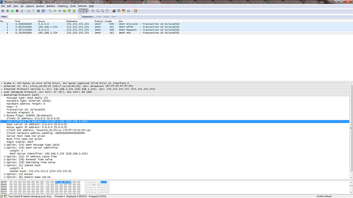

Hi all,
I am trying to write an Arduino sketch (that will be uploaded to an Arduino Uno combined with a CC3000 wireless module by Sparkfun).
This sketch should connect to a server PC, and send information via TCP/IP in the form of "1" or "0".
The problem is that the Server program (run separately on a PC with an IP of 192.168.2.13 [not static]),
does not seem to identify that the CC3000 (the client), is trying to establish a connection.
The current Arduino sketch (Client) is as below.
Of course I changed the "SSID" and "PASSWORD" with the actual SSID and PASSWORD... The CC3000 initializes and connects to the local WiFi with no problem.
Client Code (Arduino UNO + CC3000 WiFi Side):

I guess the problematic section with the Arduino code, is this:
I can't seem to understand what is wrong with it, maybe there is something missing...
// Make a TCP connection to remote host (server computer)
Serial.print("Connecting to Server: ");
Serial.println(server);
ConnectionIndicator = client.connect(server, 80);
Serial.println(ConnectionIndicator); // "client.connect" function returns an int (1, -1, -2, -3, -4) indicating connection status:
//SUCCESS (1)
//TIMED_OUT (-1)
//INVALID_SERVER (-2)
//TRUNCATED (-3)
//INVALID_RESPONSE (-4)
if (ConnectionIndicator==1)
Serial.println("Success: TCP connection Established!");
else if (ConnectionIndicator <= -1)
Serial.println("Error: Could not make a TCP connection");
This code line:
Doesn't seem to return one of the values (1, -1, -2, -3, -4)
instead it always returns "0"
which is not even in the options for this function as I understand...
By the way, the C# code (Server part) was taken from here:
The server+client code written in this page seems to work perfectly together.
I am puzzled...
Help would be appreciated a lot!
Thanks in Advance.
