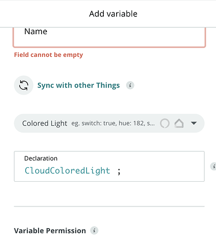

I am not 100% sure what you are looking for, is this it?

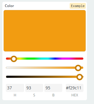

I am trying to link Color Widget to CLoudColor Variable (which i cannot find). OK, i rephrase the question. To which Variable Color Widget can be linked ? Overall, i want to change the physical RGB from Dashboard using Color WIdget
I found it )) Its name is not cloudColor, but just Color )) In other topics i understood wrongly the name of the variable
