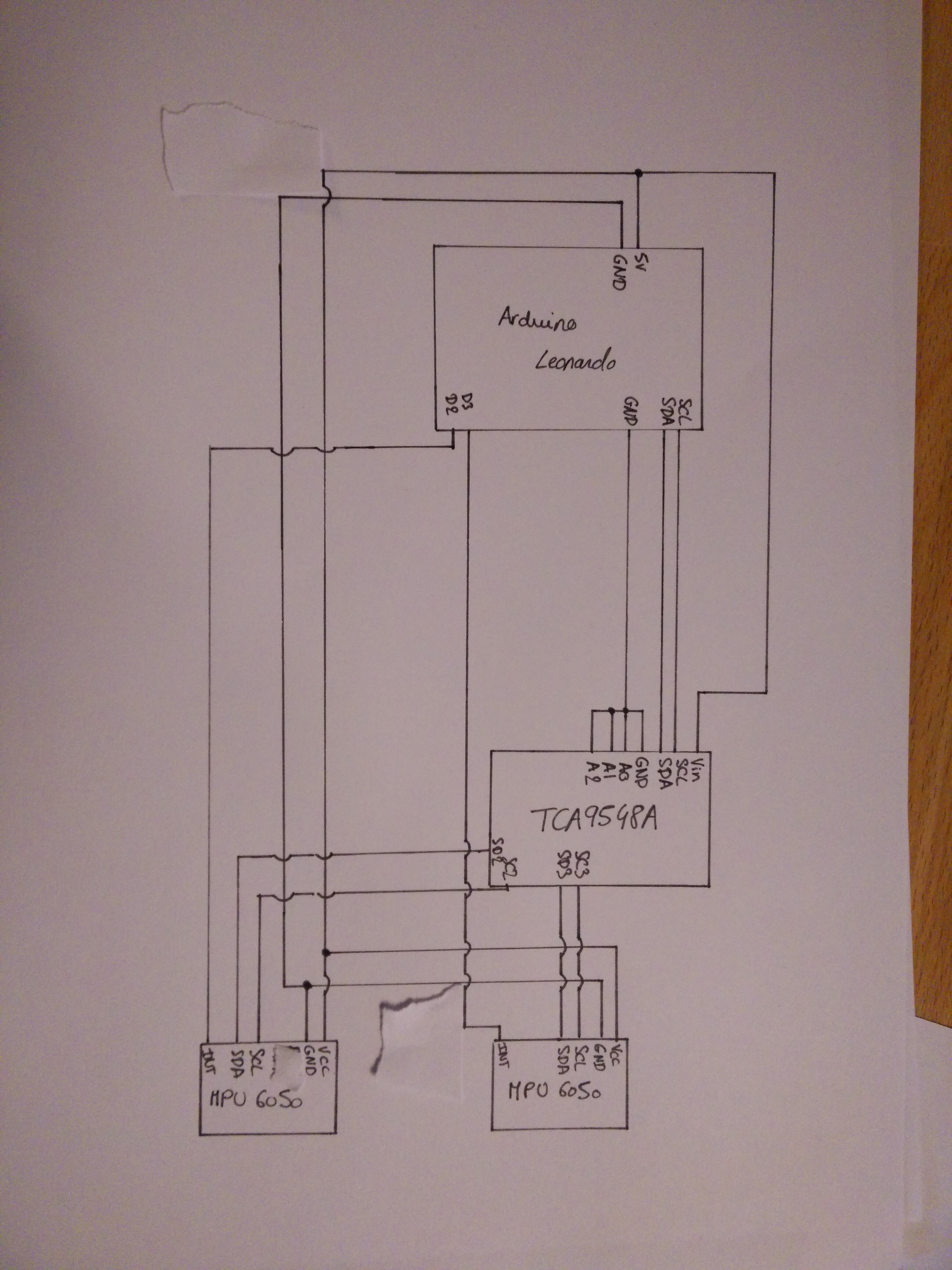

I try to make a datalogger using 3 different MPU6050. I use the TCA9548A multiplexer to communicate in I2C with my arduino (Leonardo or MKR1010, I use both but I have the same problem with each).
When I launch a scanner dedicated to find the devices linked to the TCA multiplexer I find all of my sensors. However when I launch the basic_reading script from adafruit (modified to use the multiplexer) I can't find any of the mpu.

Ok so here is my wiring
And this is my code

Sorry but that is not a wiring diagram. It's a Fritzing impressing no helper. Please post code, not text. Use autoformat in the IDE and code tags when posting.

I made a diagram, as you asked. I hope it is clear.

Have you looked at this Adafruit tutorial and looked at and tried their example with two I2C units collected?
They even have a scanner.
You just found the perfect I2C sensor, and you want to wire up two or three or more of them to your Arduino when you realize "Uh oh, this chip has a fixed I2C address, and from what I know about I2C, you cannot have two devices with the same address...
Tom...
