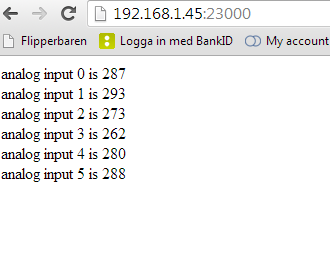

Well i simply use the local ip 192.168.1.45:23000 when trying on local network
When i´m on my other server i use our internet ip 85.225.11.155:10023.
I try both these in chrome i have also tried the chatserver with telnet from local wich works but neever from outside.

This is what i get when i surf to the arduino localy

But what the heck now i can at least start programming dont really care what port.
The starnge thing is i have tried diffrent port before .
But thanks alot for sticking with me.
