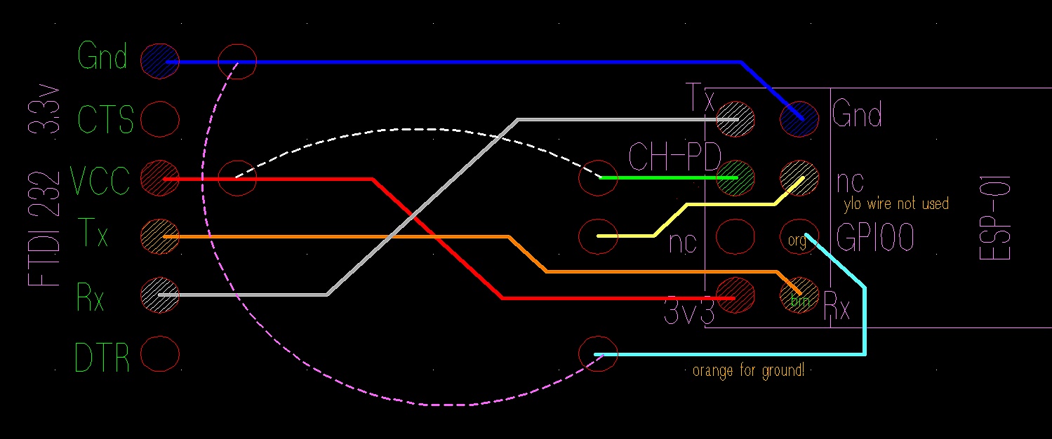

In this, my first attempt to use an ESP-01, I have run straight into a brick wall.
I assume I can use this module as it comes out of the box. The programme is just a Blink. I think it came from the library.

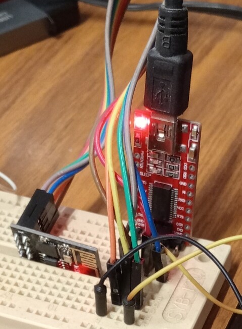

The vital thing is that the IDE said "Done Uploading", so I assume the installation, code, and wiring are all kosher.
There is a solid red LED on both the FDTI232 and the ESP-01, suggesting that power is OK for both. I understand I should be seeing a blue LED on the ESP, next to the red one.
There seems to be some confusion about the wiring but I have removed the jumper GPIO 0 to ground.
I hope I'm missing something silly....

ESP-01 gets 3.3v off the FDTI. Its red power light is on.
I'm using stuff out of the spare parts bin. The ESP-01 just has to get network time once in setup, and should be entirely adequate - if I can just get it started.......

That's not enough current. You only get ~50mA worth from the FTDI. It is sourced through the internal 3.3 V regulator of the FT232R chip, which is not designed to supply power for external devices.
You need a more suitable power (and likely a capacitor to absorb peak demand when using the radio)

This is the circuit I use to program esp-01.
To enter programming mode, it's necessary to hold down the flash button while you click the reset button. You should see a single brief blink from the blue led. Then you can upload your code from the IDE.
After upload has completed, I think it's necessary to click reset again (without holding down flash button) to start your code running. You should see 2x brief blinks of the blue led.

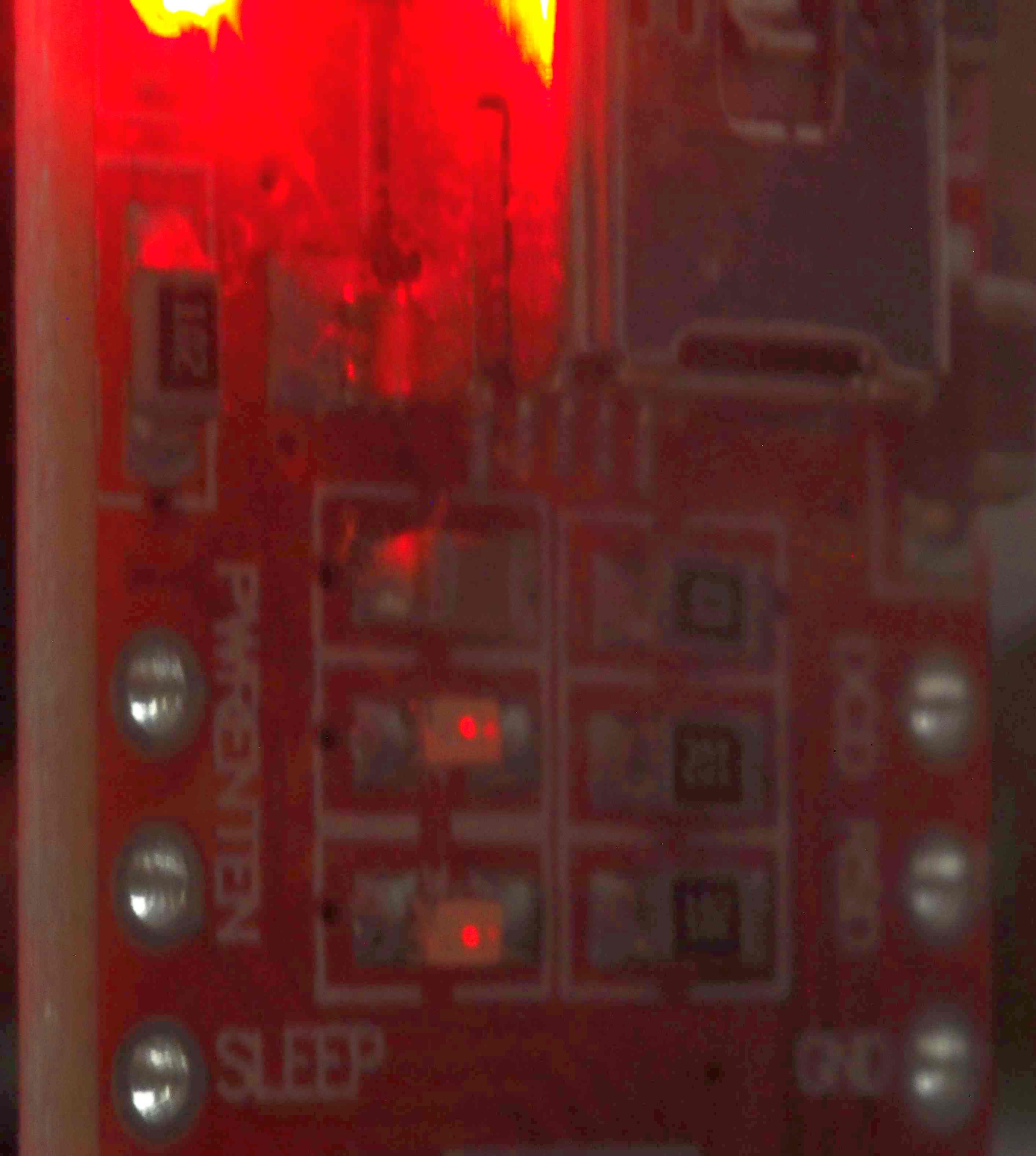

Still no joy. I guess it's all too fiddly and I need to put in switches following post#9. Now the sun has gone in I can see two little LEDs flashing on the programmer that I haven't seen before. They flash as long as CH-PD is on VCC.
This could be the something silly I need but am not doing and, when IDE says "Done uploading", it's lying.

Look at the table at the bottom right in this diagram. It shows how the mode of the ESP is set at power-up/reset, based on the voltage levels of gpio0 & gpio2.
You want "serial programming" mode to upload your code from the IDE.
You want "boot from flash" mode to run the uploaded code.
So maybe you need to connect gpio2 to 3.3V also.

Can you post a picture of your ESP-01.
