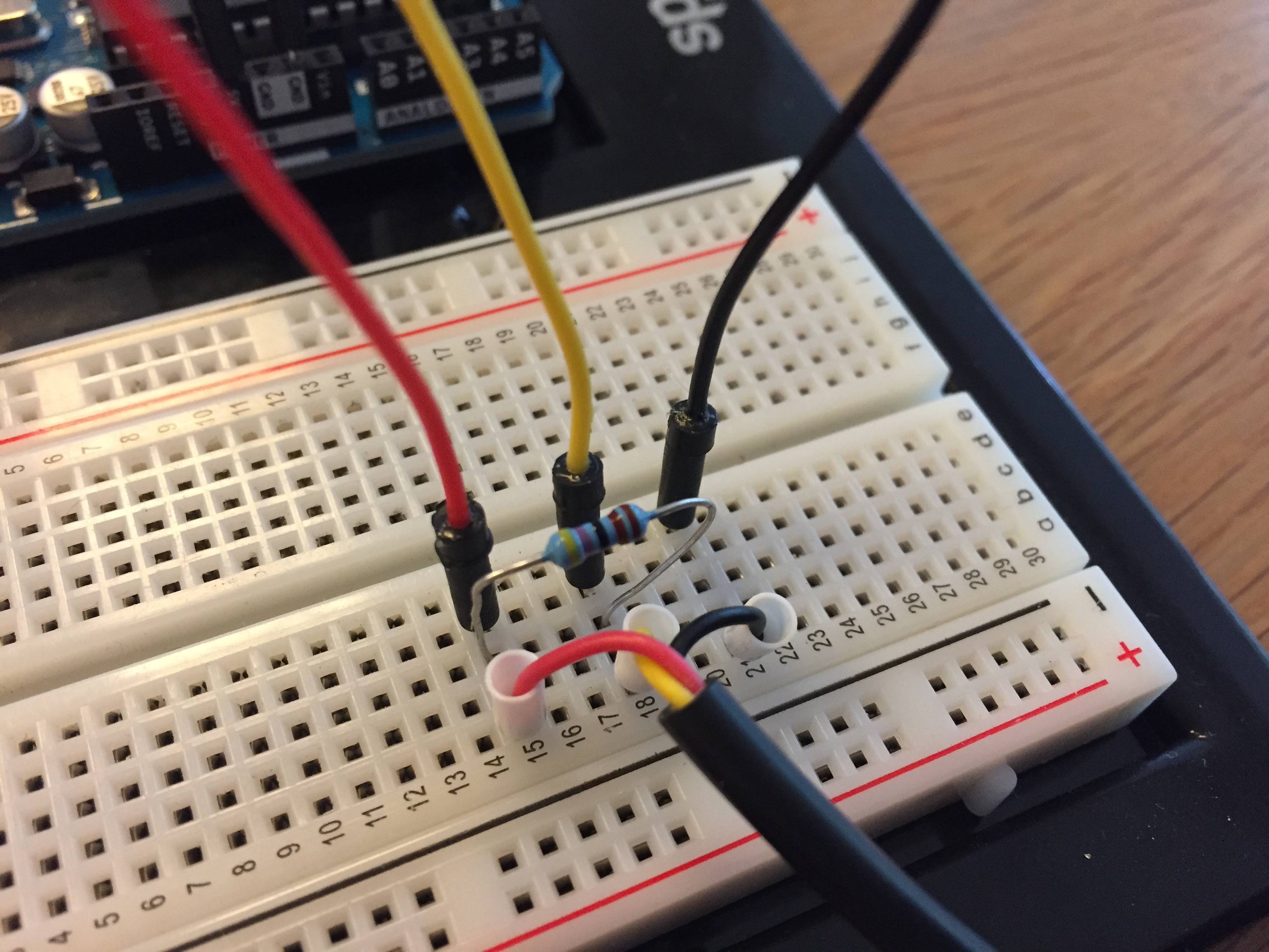

Can't get my DS18B20 to work on Arduino Uno

If that sketch only prints "That's all." then it hasn't found any DS18B20 devices at all on pin 3 which means you haven't wired them properly. The sketch should print the ROM address of each DS18B20 on pin 3 before it prints "That's all." Maybe I should modify that sketch so that it prints a different message if it doesn't find anything.
Draw a diagram to show each of the 3 pins on the DS18B20 are connected.
Pete
(deleted)
I shifted all my pins 3 holes to the left
I don't understand this at all. Which pins? And "left" has no context for me.
The photo in your original post is very clear except that it doesn't how the red, yellow and black wires are connected to the Arduino.
Pete
(deleted)
GND 17, digital 13 and 5v in 10
The GND wire on the ds18b20 must go to the ground connection on the Arduino.
The power wire (Vdd) on the DS18B20 must go to the Arduino's 5V connection.
The code you posted uses pin 3 for the DS18B20. There's no way that connecting the DS18B20 data pin (DQ) to pin 13 is going to work unless you also change the code to use pin 13.
You can't have had everything connected correctly and it looks like you still haven't.
Pete
