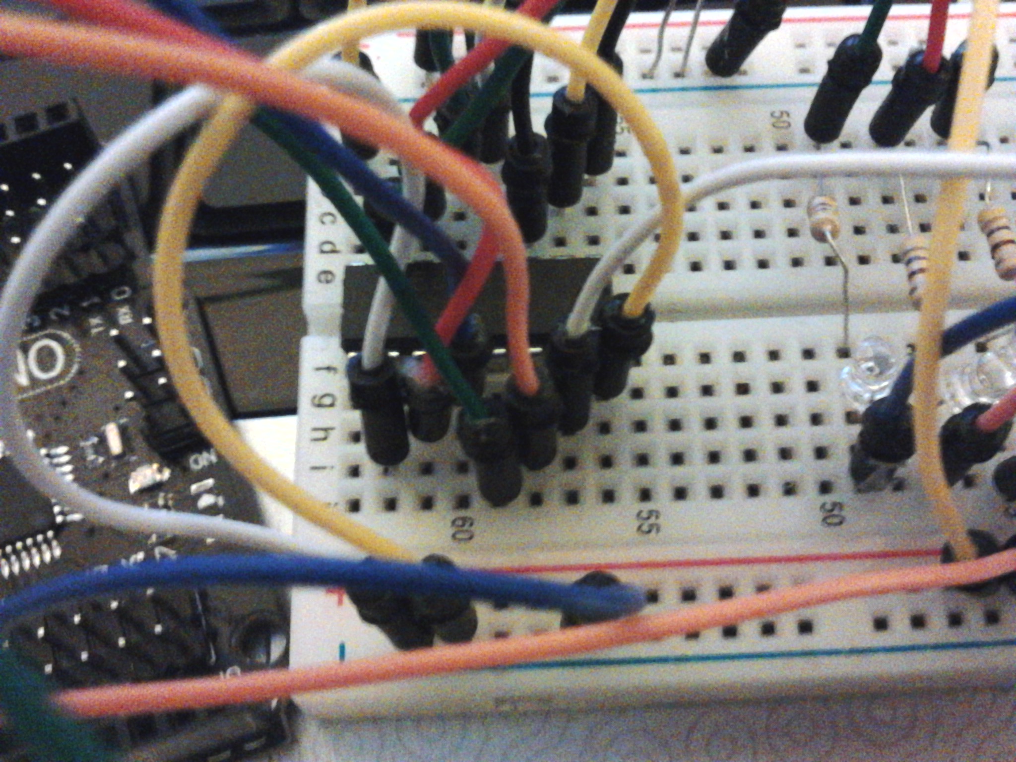

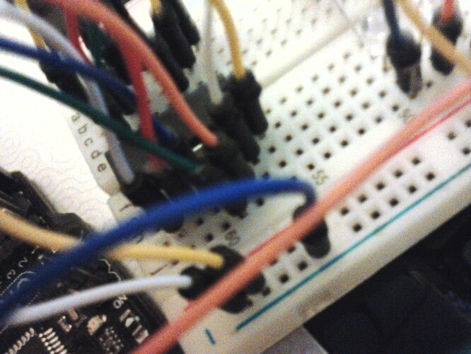

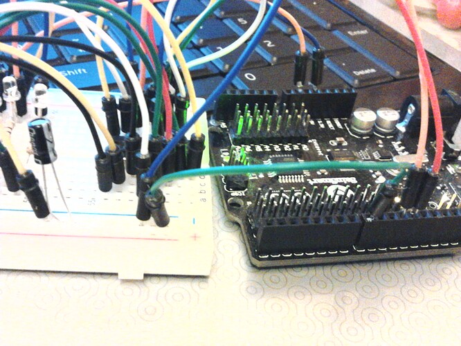

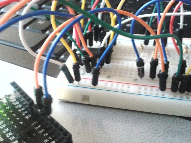

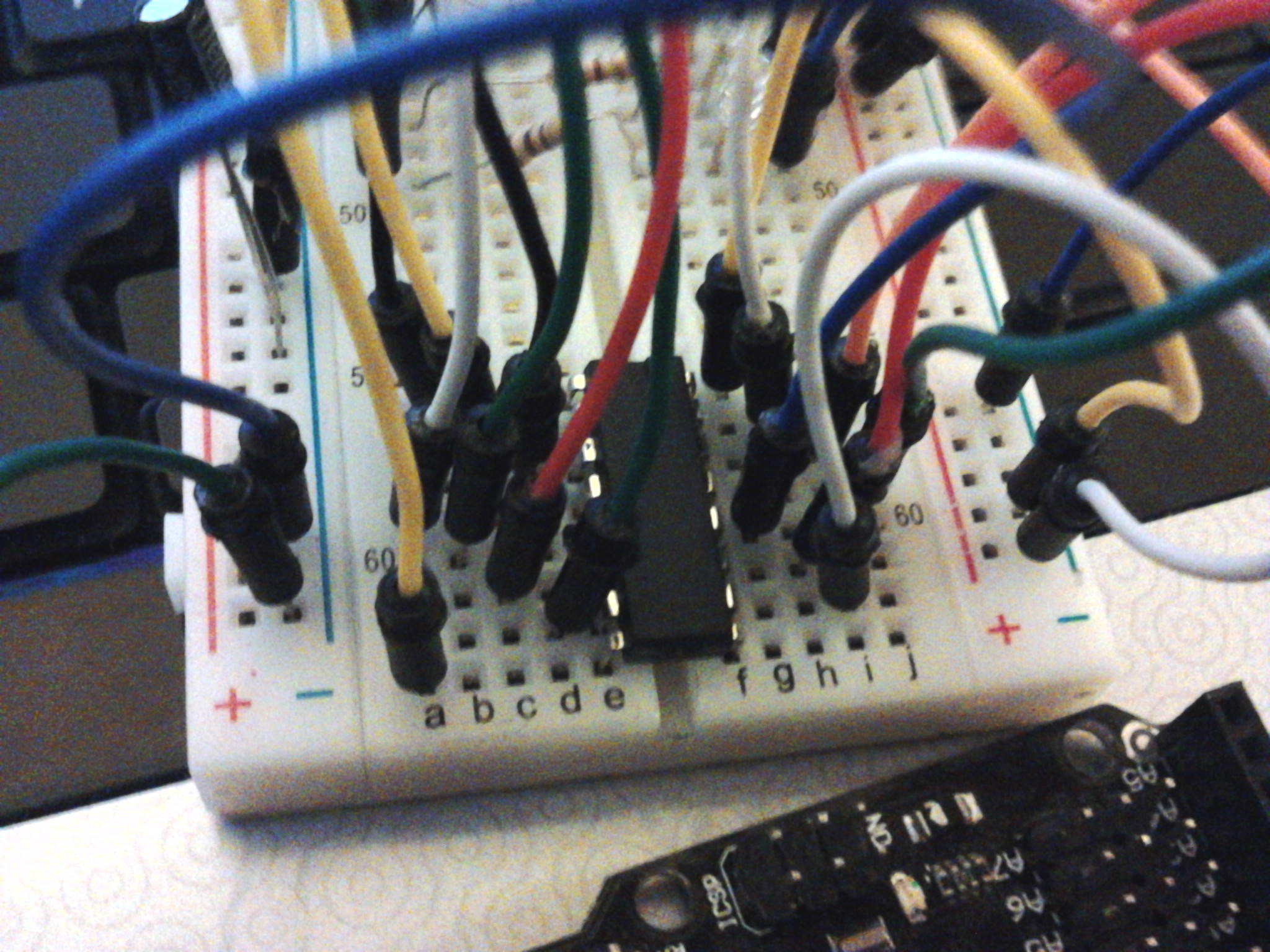

Here are some pics of the circuit. I tried it with and without the capacitor (I'm using a 10uf one, would that still work where only 1uf is needed?)
I have tried the LEDs going both positive to negative, and negative to positive

You are not using the breadboard correctly. Each small group of 5 pins are connected together - you need the LED legs to be in separate groups.
Same with the long strips down the sides - all the pins in a strip are connected together, the large cap needs to have a leg in each strip.
Ah, that must be it. I thought it skipped the breadboard connection and went just through the LED. Suppose that makes splitting a connection easier.
Thank you so much, I've been puzzled over that for ages.
