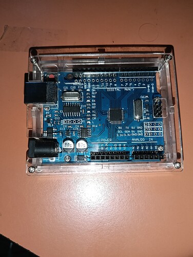

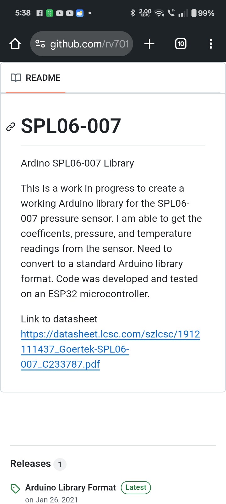

unfortunately i don't have an actual uno hand just a r3 clone with the CH340G driver and SMD Atmega328P i will provide a clear pic in the comments for reference , but i got it from TEMU in Australia ( please for give me Arduino gods ) work fine just had to update the ch340G drivers for it to work , im trying to get the SPL06-007 to work internal but it wont even read the temp and altitude or pressure like i was saying from what rv701 said in his GitHub post with the attached library its made for esp32 but will "Need to convert to a standard Arduino library format. Code was developed and tested on an ESP32 microcontroller." , how do i even get theSPL06-007 to run on Arduino ? i have plans to implement the SPL in the some projects but i cant even get it to return correct data let alone implement in personally , i tried to "fix" the coeffects by replaces the whole .cpp and . h files with the ones found in the aforementioned linked post but it returns this in the serial monitor

R3 clone I'm using

In the GitHub description for the library it does say it needs to be converted in what ever regards for it work with Arduino, unfortunately rv701s library is the only library that works remotely close with the SPL06-007 , I know the sensor works and talks to the clone and Configs do some what work
I didn't see that anywhere.
Are you using this library
Can't see if it's the same library.
Please give the web address
seem to have the same spelling error ... (for what it is worth)
yeah, i confirm jim-p you and i are reading the same docs, in the last 10 mins of checking the docs i did find a "pull request " with notes saying its a number problem in the handing of the coeffects and the fact that its for esp's 32 bit system and the duo being 16 bit i have linked the exact docs i was reading , i am heavily open to correction on this so feel free to correct me if I'm wrong . its late for me at the moment but i will do an update in the original post on some more info i have found about the SPL06-007 its self in the morning but is still have not tested the attached finds .
OK, well the library is 5 years old and the last update was 4 years ago with no effort to make it compatible.
