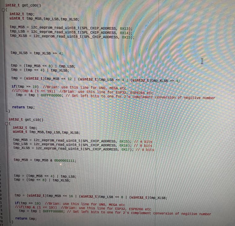

Now, the SPL06-007 library was downloaded via IDE Library Manager. I decided to do a test on a spare UNO (Wifi Version from Jaycar XC-4411). It did not work at first then I came across a post stating the SPL06-007 had issues when dealing with 8 bit processors such as the UNO as the author, rv701, developed the library using an ESP32 which is 32 bit. They advised minor code changes in the SPL06-007.cpp file. I did the changes and the UNO worked.

NOTE: The LilyGo T-Beam performed no differently both before and after modifications to the SPL06-007.cpp file

The following is my test code (which is exactly the same as rv701's library for SPL06-007:

I'll upload the following files:
  • Barometric_Pressure_for_Lilygo.ino
  • SPL06-007.cpp
  • SPL06-007.h
Barometric_Pressure_for_Lilygo.ino (2.5 KB)
SPL06-007.cpp (9.0 KB)
SPL06-007.h (1.2 KB)
By the way, I simply held the SDA and SCL wires against the soldered joints of the OLED which did the trick. This is why you cannot see any wires from these points to the SPL06-007 in the photos provided.
