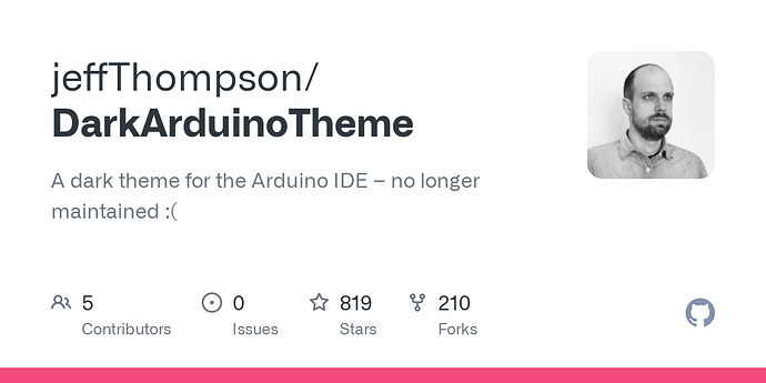

I found a change for dark mode for IDE on GitHub and a demonstration of installing on youtube. For me the youtube version the screen capture of characters is too blurry to follow.
this is where I found it originally.

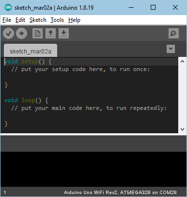

The Arduino IDE should now start and have the new theme.
I just tried it out and it works:
just to be clear, I do not need to rename or remove the original theme which will still reside in the lib folder. right?
Correct. The IDE will use the one installed in the sketchbook folder instead.
