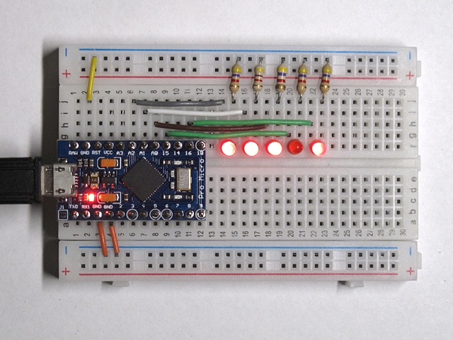

I just put a Pro Micro on a breadboard with your sketch and I'm not seeing anything unusual. LEDs on A0, A1, A2 and pin 16 are flashing, and the LED on pin 15 stays off.

This is what I saw (and expected to):
off
on
Left to right: A2, A1, A0, 15, 16.
I happened to have two of these boards, so I tried the other one, also brand new, it's exactly the same with that one.
The both looks exactly like your board @van_der_decken , the pcb routing looks the same too.

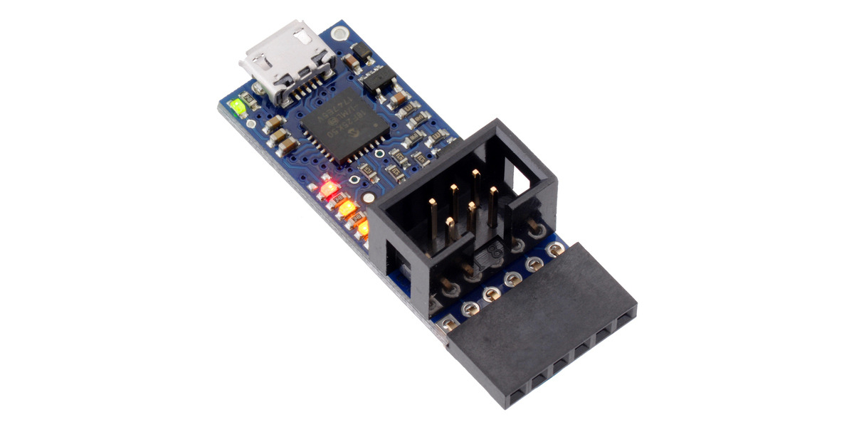

This is the best AVR ISP programmer I've ever used, which also doubles as a USB-serial converter. Comes with a nice GUI that allows you to control various options, and works well with both 5V and 3.3V MCUs.
