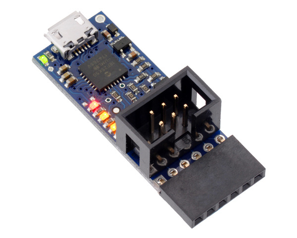

Get a Programmer, or use our Elegoo as one, put on a known good bootloader.
$7.77, free shipping in the US. Always good to have a working tool around.
I have previously posted about using it.
Bingo! I tried the AVR ISP progammer, being the first on the list, and it worked! Confirmed by changing the blink delays and re-uploading. Many thanks (and a bit of karma!).
