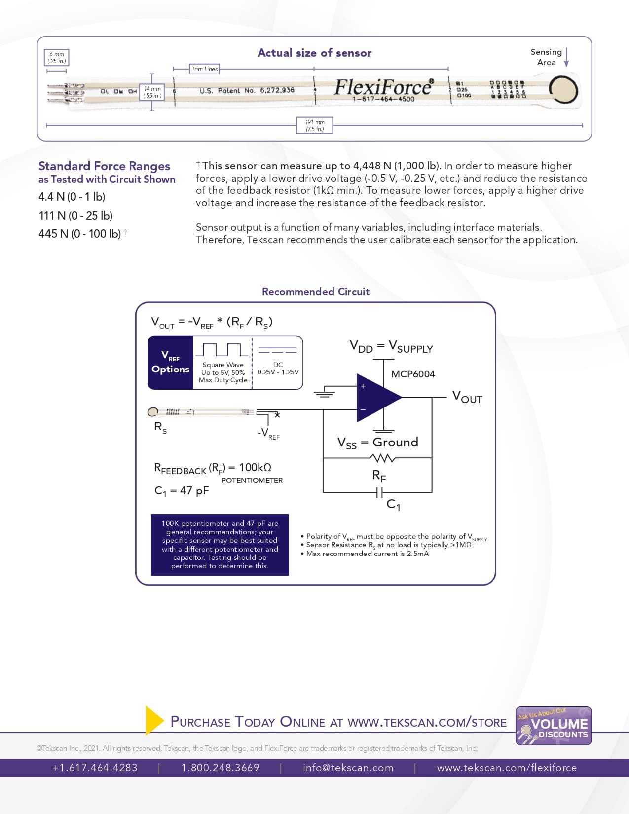

Yes, FSRx are force sensitive resistors. Am I attaching the capacitors correctly, like you advised 'input to ground' in the schematic? Please see the datasheets in the jpgs.
Since the ground resistance is 100k, a capacitor would not do much for you.
A ceramic 100nF capacitor across the 100k would be recommend.
No, do as @LarryD suggests and place the cap across the 100K load resistor. You have it Vcc (5V) to ground.
