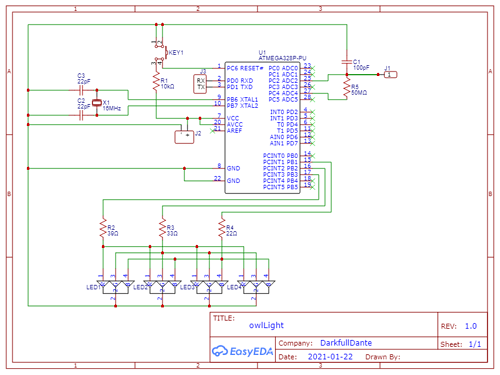

I'm working on an standalone AtMega328P project that uses a capacitive sensor as a button, but I'm getting stuck right now. The project does work without problems on an arduino board, but as soon as I upload on a standalone AtMega328P the capacitive sensor is no longer working. The project is an LED lamp. The code is on github here. Also here is my schematic:
I'm currently using the <CapacitiveSensor.h> library with a 50MΩ resistor between pin 4 and 2 with a 100pF capacitor to ground. I was able to get consistant readings with the board, but I get the error value "-2" with the AtMega328P.
If someone can tell me: is it only possible to use capacitive sensor this way with a standalone microcontroller, if not, what can be done? Also, if someone is able to tell me why it cannot work on the microcontroller as a standalone, I'm still very interested in understand how they differ and how to mitigate this.

Ok, I'm just so f*ing dumb... I plugged the capacitive touch in A2 and A4 not the digital pins. Makes a lot of sense why I was getting a time out error (-2).
Wouldn't you know it, it works perfectly when you wire it correctly. That'll teach me to check my wiring before posting next time.
