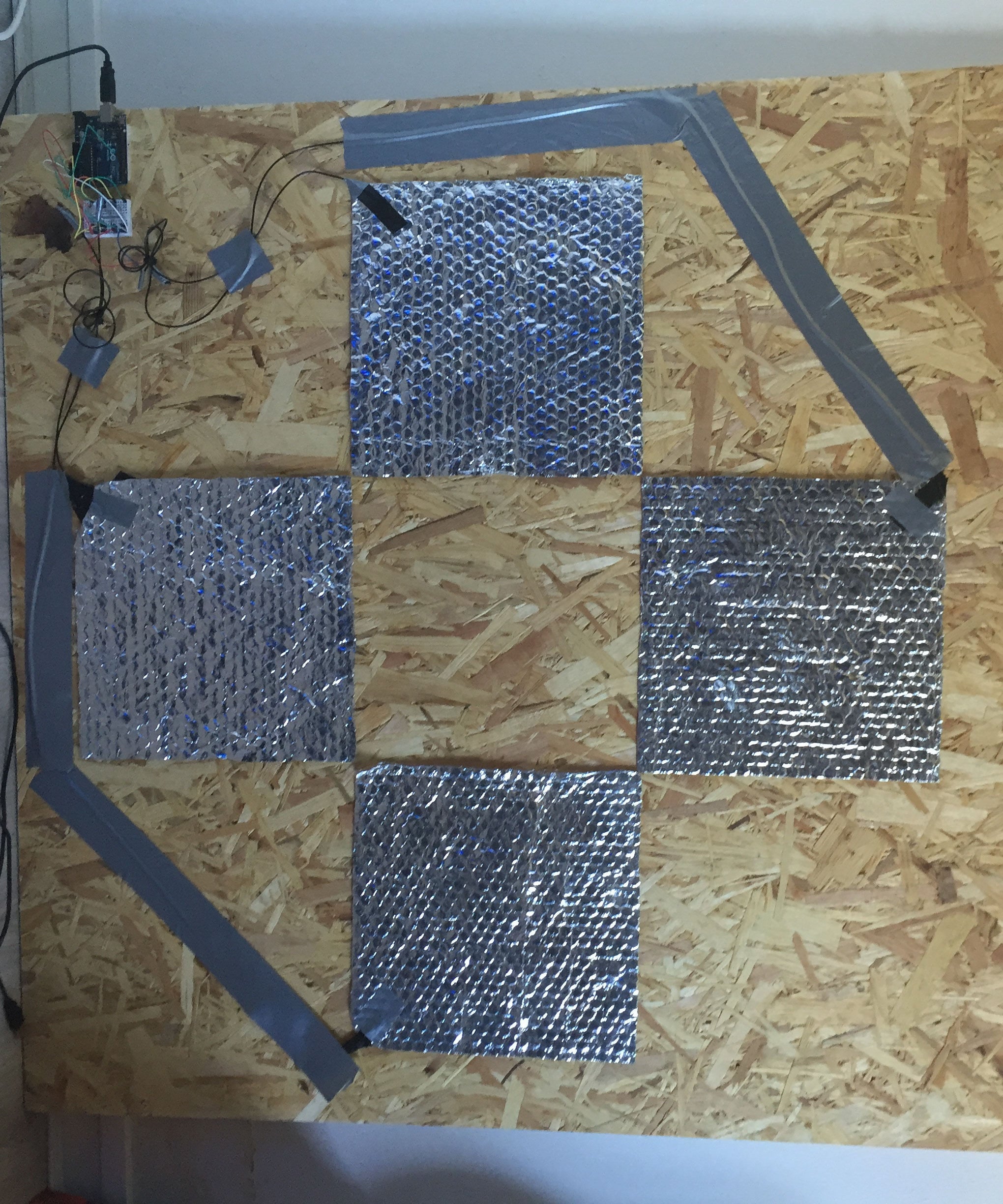

I'm trying to develop a DDR like dance pad, I'm trying to keep mechanical part simple and cheap as possible, so thought about a solution without moving parts, so this solution appeared.
I never worked with capacitive sensors.
Do you think this is possible?
Which is the expected latency for this?
My plan is to cut aluminum foil (like roof gutter?) and place on a large wooden board (about 1x1m).
One know problem is about the grounding, If I put a wire under this wooden board can solve? Or a full aluminum? (if necessary).
Fo who dont know, DDR is a dancing game, generally a mat with arrows are used as controller, placed in the floor, the arrows appears in the screen syncronized with the music, you need to step on correct arrow and in the correct timing.
So, timing is important here.
Each arrow will be kind 30x30cm, I need 4 of them + 2 smaller ones (for start and back).
Thank you very much.

My plan is using that "thick" aluminium foil used for roof gutter.

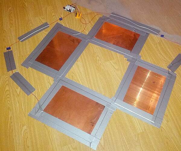

There are other people doing this, take a look:
Looks promising, but I'm worried about the latency, also, those projects just accept 2 triggers at same time.

Yes that sort of thing is a problem with the very crude method of detection used. Note how everything is taped down so nothing moves.
I would recommend you get a proper cap sensing board then you can fine tune the trigger parameters.
Problem is not the latency itself as I can make the game deal with it, but the latency variation will be a problem.
