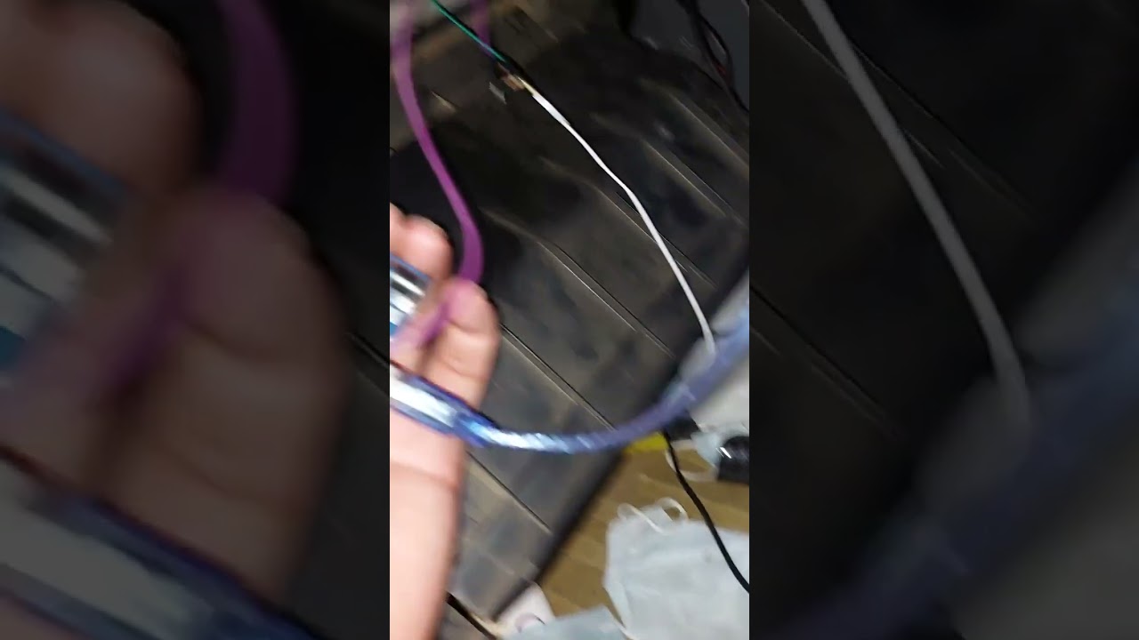

I did resistor jumper testing from 1M to 10k and engine doest stops but then i connect 1k and it stalls.
I connected the sensor input to 10k resistor and other end to ardunio pin-2 setup as INPUT. Without connecting grounds, its counting pulses. I pushed a paddle little bit and the count went up.
but count and pulses from sensor does not match.
Thanks.
See post #12 #15 and #20
Now, i have done that.
Kindly check video.

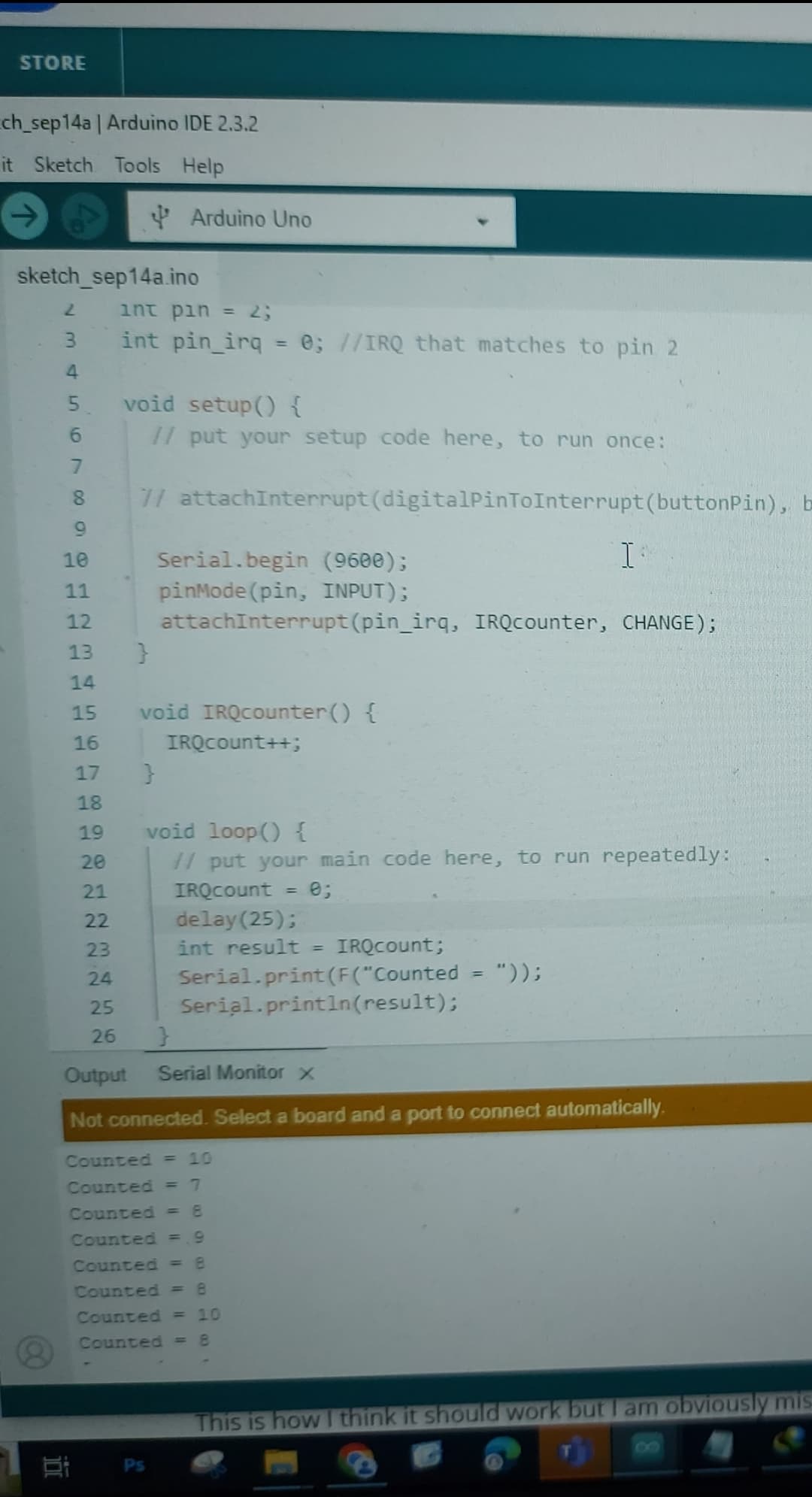

volatile int IRQcount=0;
int pin = 2;
int pin_irq = 0; //IRQ that matches to pin 2
unsigned long startTime=0;
unsigned long nowTime=0;
  Serial.begin (9600);
  startTime = millis();
  pinMode(pin, INPUT);
  attachInterrupt(pin_irq, IRQcounter, RISING);
void IRQcounter() {
  IRQcount++;
if (  millis()-startTime >= 1000)
  int result = IRQcount;
  Serial.print(F("Counted = "));
  Serial.println(result);
   IRQcount = 0;
At engine idle, it gives, +- 171 pulses/interrupts. with 1K resistor.
While +- 150 pulses/interrups with 10k resistor.
The pulses do respond when accelator paddle is pressed.
Thanks.
The interrupt pin is very sensitive to noise. Use the 1K
You need to make the wires between the Arduino and sensor much much shorter. It's probably picking up noise from the spark plug wires.
Also the ground from the Arduino should connect to the Engine ground not through the door catch.
Don't hold the Arduino in your hand it just makes noise pick-up worse.
