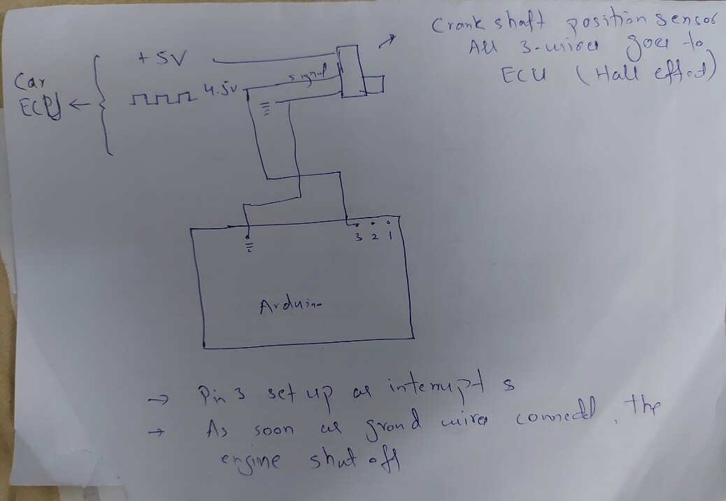

I need to count the pulse signal. when measuring pulse through arduino uno, i connect pulse signal of crank position (the 3rd 4.5v) to ardunio interrupt pin 2.
As soon as i touch the arduino ground pin to car ground, the engine stops everytime.

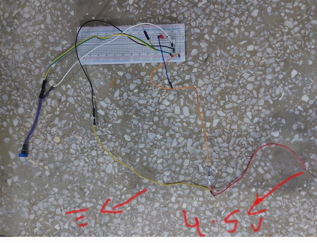

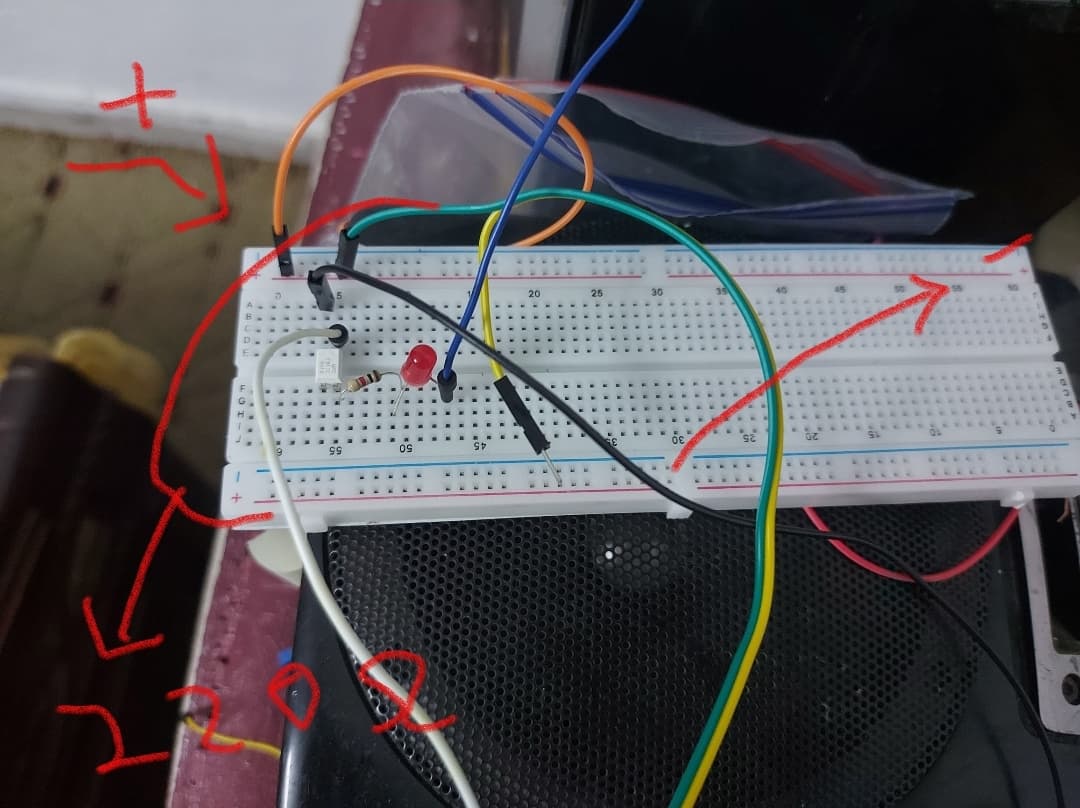

As a2nd experiment, i removed the arduino and simply connect a pc817 optocoupler with 220ohm resistance to Signal 4.5V. But as soon as i touch the 2nd (gnd) wire to car body, engine stops.

The drawing of both are attached. why does the arduino interrupt schematic shut off the engine.

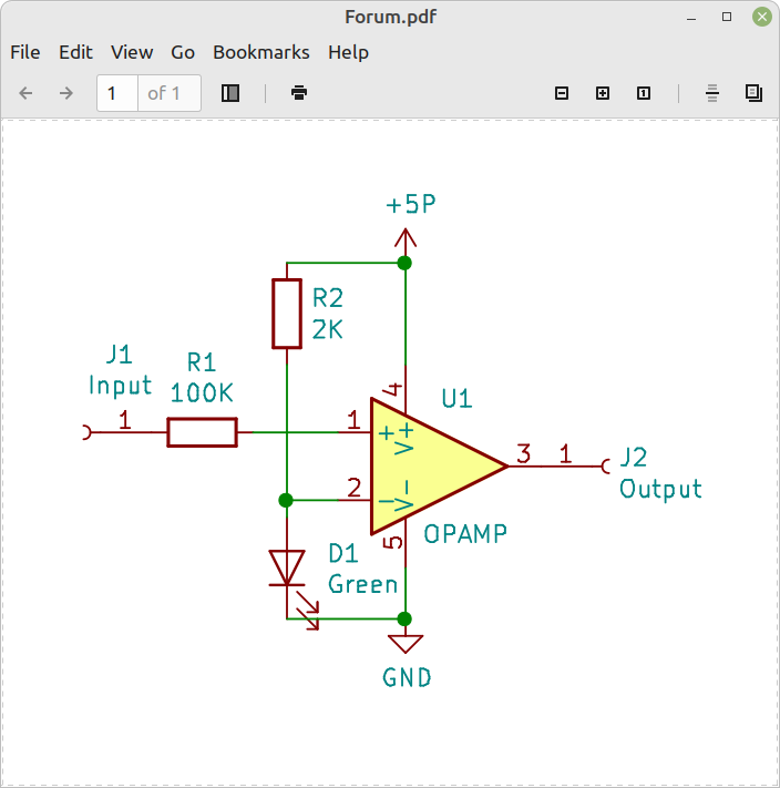

It appears it is a VR (variable Reluctance) sensor. The ones I have worked with have a high impedance and will not supply much current. Following is a simple circuit that should work for you. Start by checking if the sensor ground is the same as the vehicle ground, if not stop.
The LED is acting as a voltage reference (VF of LED) to bias the comparison point. The VR signal is fed into the input, the output is your signal. It is dependent on the op amp or comparator you chose. If you use a comparator you will need a pull up resistor. Do not power this from the ECM. I have used this circuit many times.

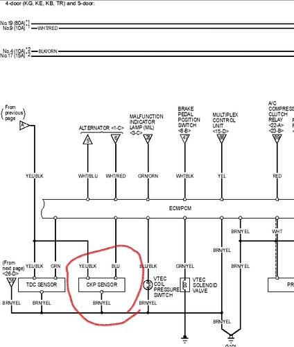

Thanks a lot. Could you suggest Oamp or comparator Number please. Yes i checked car wiring diagram, ground is same as car body.

If it has 3 wires and outputs a ~4.5V signal, then it is a Hall Sensor NOT a VR (Variable Reluctance) sensor.
Where does the Arduino get it's power?

The YEL/BLK wire is 5V feed from ECU, Blue is 4 or 4.5 signal wire and BRW/YEL is ground.
