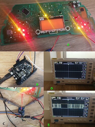

01 _ About the circuit:
A) this is the FIAT Punto Dashboard
B) this is my UNO
C) this is my MCP2515 with osciloscope probes to test it.
D) this is the signal when the dashboard is not powered.
E) this is the signal when i power the dashboard in key contact (+15)

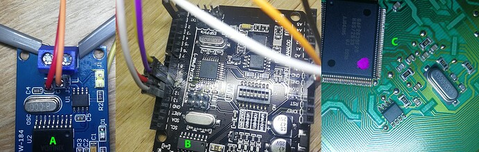

02 _ About the crystals:
A) MCP2515 - it is a 8MHz with no doubt
B) MEGA328P - I think the ECS 160 EX crystal is to work with ESP and the other one that works with MEGA has no marking. I bought it as a 16MHz
C) in the dashboard, near the TJA1054A transceiver there is a crystal with a different marking of 8 and 16 MHz. Could this be a problem?

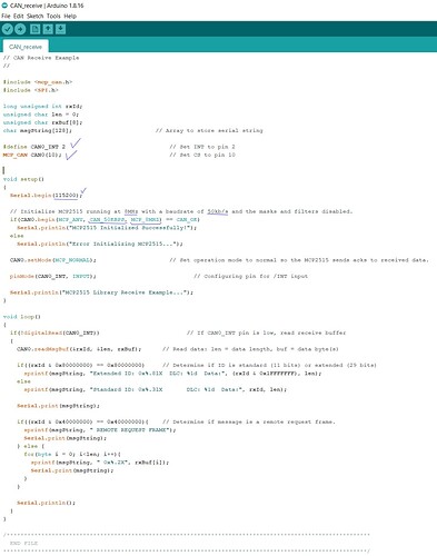

Try the CAN_receive.ino and set the 8 MHz option. Make sure there is a ground wire linking the dashboard to the MCP2515 module.
If you get nothing try swapping the High and Low wires.
If that doesn't work then use the oscilloscope to measure the width of a single bit and use that to calculate the actual baud rate.
So I followed the recommendation and:
1_ copied the sketch coryjfowler Update CAN_receive.ino
2_ according to the image, I went back to following the same steps in the code change.
3_ connected the GND of the source that supply the dashboard in connection with the arduino that supply the MCP. So the GNDs are all connected.
4_ loaded the program to UNO with the same keys turned on (3 & 4) All ok with the loading.
5_ I turned on the power supply and the oscilloscope started to detect CAN communication measured on the MCP board.
6_ I opened the "serial monitor" with 115200baud, just like what was written on the sketch. The result is this (see the image): no communication appears.
7_ changed the CAN L & CAN H cables but it stayed the same. I am sure that the cables are right connected because I have the dashboard wireframe and the pin function.
8_ seeing the oscilloscope, I check the data I send in the image. It may not be 100% strict. I would like to know how to calculate the baud to confirm that 115200 value. If the measure of a single bit is the same in both CAN (High and Low), I think it's 4,5V = VPP??
9_ if the crystal in dashboard has not the same value, why we use 8MHZ?

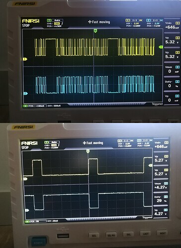

Please follow mikb55 advice and measure the CAN bitrate with your oscilloscope. Pick the narrowest bit. Measure the time and take the inverse to get the bitrate. e.g.,
20 µs -> 20 / 1,000,000 -> 0.00002 s -> 1bit / 0.00002 s = 50,000 kbit/s
Reply #5 E looks like 50-60 kbits/s CAN. It is hard to tell from the picture and the resolution.
Reply #10 looks like 50 kbits/s CAN.
A 16MHz crystal is the only one that allows all CAN standard baudrates to be created by the MCP2515 (and a few in between). The 8MHz allows all CAN standard baudrates up to 500kbits/s to be created.
But my question about the crystals is:
in post #6 I published a photo with all the crystals of the 3 devices.
they are not all the same value. Why not choose the crystal from dashboard (5MHZ) as the default value instead the crystal of MCP (8MHZ) ??
about measuring the CAN bitrate:
in fact i have a network with 50kbps because the value of a unit is 20µs.
So what should be changed in the code besides CAN 500kbps - 50kbps ??
The baudrate changes to??
thanks in advance
The dashboard CAN controller creates the CAN bitrate from the 5MHz crystal. This is done by the internal hardware and you do not need to worry about it. Only the 50kbits/s you measured are important.
Your MCP2515 needs to use 50kbits/s. To configure the MCP2515 correctly you will need to tell the library the frequency of the crystal. If you tell the library the wrong frequency the bitrate will be wrong. e.g., 16MHz vs 8MHz will cause 100kbits/s instead of the 50kbits/s.

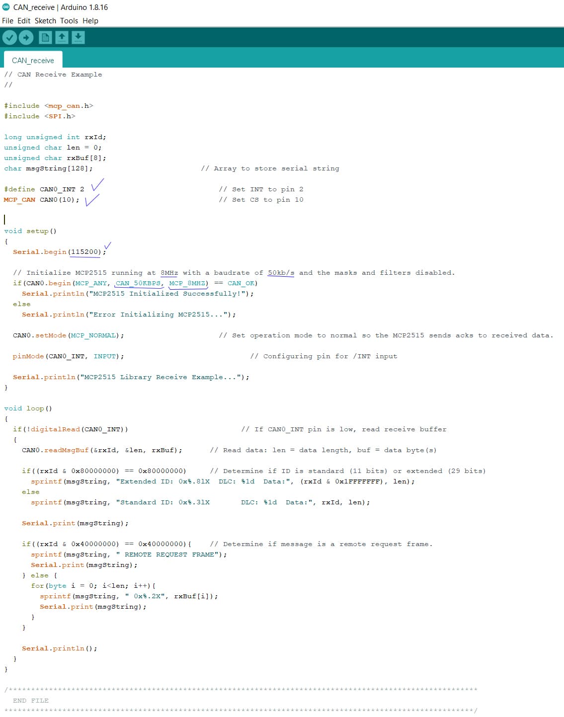

I already configured the code of the CAN_receive file and I leave here the comments of what I changed.
so what should i change in the mcp_can.h library?
in SPI.h it is not necessary to change anything?
(I only tested the sketch with changing the file, without changing the libraries and I couldn't see any communication on the serial monitor).

Please do not post code as images. Use code tags and copy the code from the IDE.
When you click on this icon </> you get.
type or paste code here
thanks Klaus_k
I just put the code in an image to make it easier to mark what I changed from the original code.

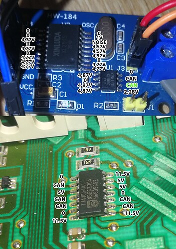

Check to see if pin 4 on the TJA1050 chip has a signal that follows the CAN bus signal. If not then the transceiver Rx may be broken.
Check to see if pin 2 on the MCP2515 has the same signal as pin 4 on the TJA1050. If not then there may be a soldering problem.
(The chips are aligned in opposite directions, hence the pin numbering looks strange.)
With these small components you may find it easier to grasp a sewing pin or needle with the oscilloscope probe and then use the sharp tip to make electrical contact with the chip.

so these are the results:
When the arduino is off, the only pin that receives CAN communication from the dashboard is the pin marked in green.
These chips are not the same of your image. they are compatible but not equals. Could this is a problem ?

There are two signals very close to CANL and CANH. They look like constant voltages but actually have a slight variation of 20mV. Are they normal?
