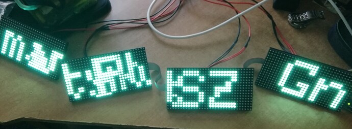

Cascade connected 16x32 rgb matrix. Problem with too little buffer to letters
I'm making project with my friend during my studies, which is called little advertisement. We have a huge problem with buffer, which is too small and letters are overlapping each other when string size is bigger than 21 letters. I ask you for help with making the buffer bigger or if you know another way than can help with my problem I will be grateful. Thanks for any reply. I attach code and photo of the result.

Thanks. What kind of Arduino are you using? Mega?
I am not certain that this line is correct:
      matrix.print(str[d]);
The method of accessing a certain character in the string works for character arrays, but maybe not for String class. You could try
      matrix.print(str.charAt(d));
Firstly thanks for trying to help me with project :slight_smile:
Yes I'm using Arduino Mega.

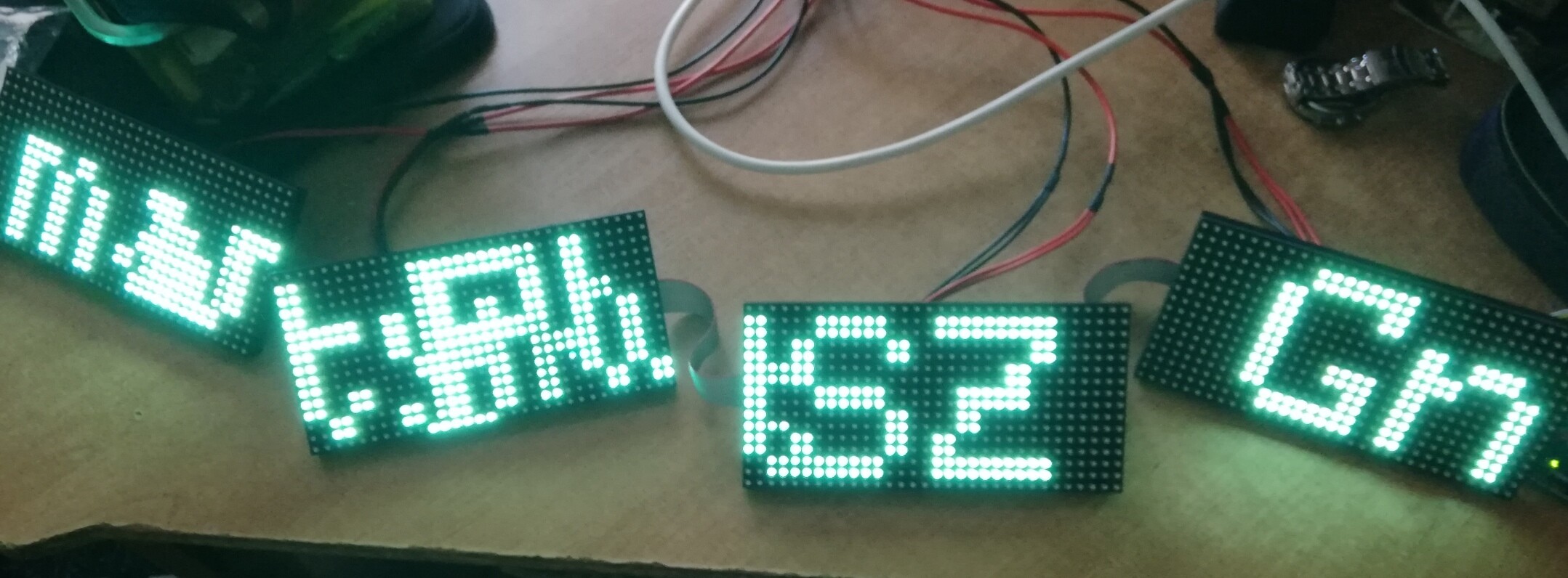

Unfortunately, the problem is still alive. I think the problem can be in hardware library. I tried to make some changes but it only getting worse and worse . :frowning: I attache the photo of the result.

The constructor for 16x32 panels does not seem to accept a parameter for the width. The constructor for 32x32 panels does have a width parameter.
EDIT: the above is from the AdaFruit library.
Which version of the library are you using? Did you install from library manager or from zip file?
Looks like this fork of the library allows the width parameter for 16x32 panels.
There is the link to GitHub which i downloaded library. I installed it from zip file. I was searching a long time for it.
Raizer68:
Yes, that is the library where the 16x32 constructor does not have the width parameter. Try the other library I found. You will need to delete the AdaFruit library folder from your libraries folder, then install the other version from the zip file.

The library with the width parameter in the 16x32 constructor has not been updated for 5 years. The Adafuit library has been updated a few days ago. This is not going to be easy. I suggest you go back to the Adafruit library and then raise an issue on the GitHub page saying that the 32x32 constructor can accept a width parameter but the 16x32 constructor cannot, and can this please be fixed because you are trying to connect 4 X 16x32 panels. Perhaps Limor will be kind to you. But there is no reason for her to be kind, because I guess you did not buy the panels from Adafruit?
