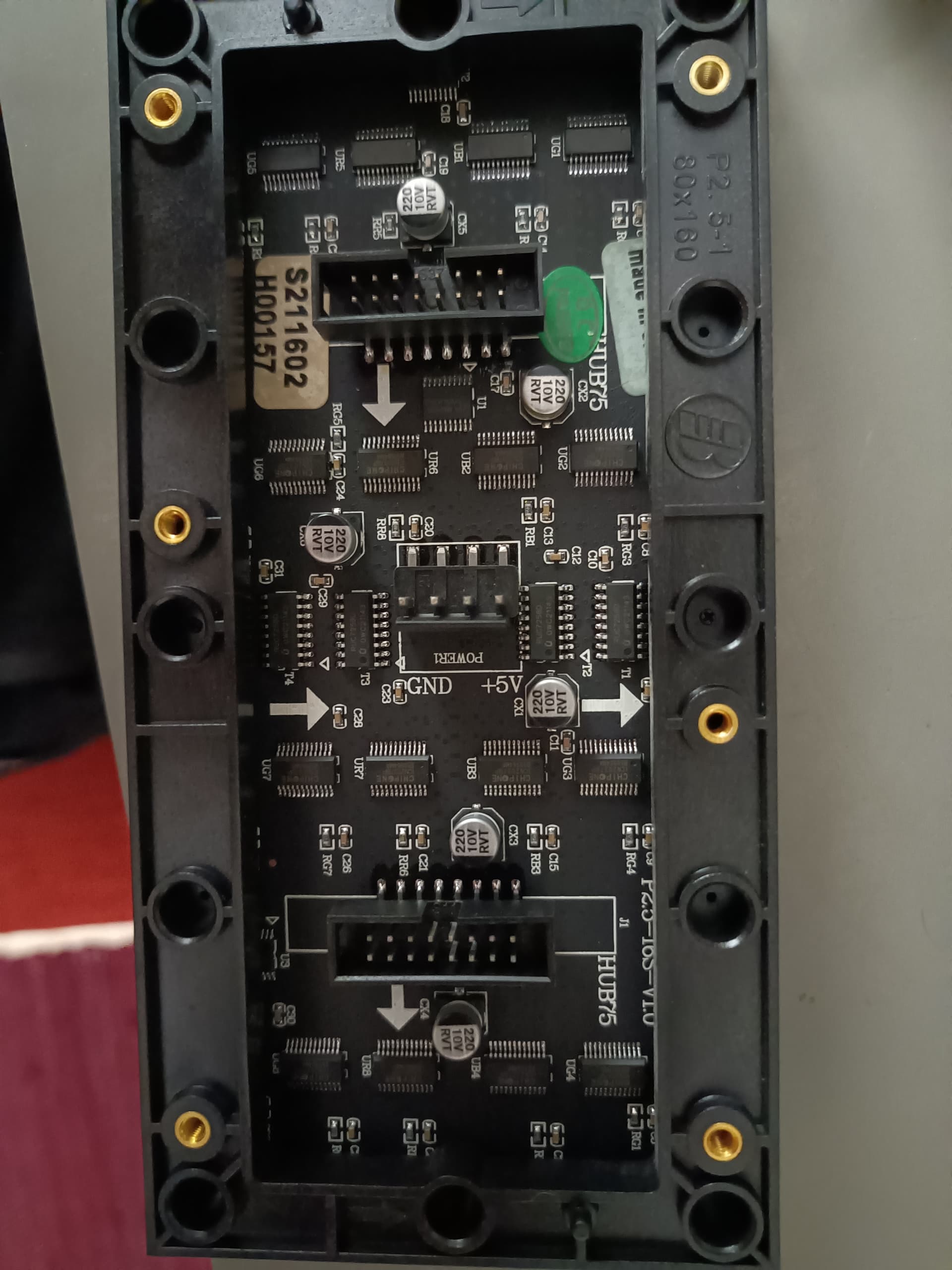

Hi I today recived my 64x32 adafruit rgb led matrix. Insted of seeing any patterns i only see half white and half pink.
I am connected to arduino mega and the matrix is connected to 5V 3A power supply.
I also made sure everything is conncted to change

It seems that the matrix is uncompatible with library. Please provide more info about panel - docs, link to the seller, clear foto of rear side...
I bought it from adafruit directly
adafruit sells many different matrices. Could you copy the labels from the back of your panel or upload the clear foto.
The panel on your foto is P2.5 64x32 s16, it should be works fine with the library you used. And I dont see any errors in the code. I have a similar panels, maybe i can try your code tonight.
I know that the problem
I didn't quite understand you. Do you know what the problem is?
No I said I know everything should work and it doesn't
Maybe something scaled down

Can you tell me the marking of the chips on the back of the matrix?
dzh121
maybe it makes sense to try other libraries. Although it's more like problems with hardware
That is very weird if it is a hardware problem because its brand new and I got it directly from adafruit. From where do I send to adafruit a request to refund or a new matrix?
As i said before, Adafruit sells many types of RGB matrix. Some of it are incompatible with RGBmatrixPanel library.
Please indicate labels on the chip on the rear side of the matrix, I will see what you can to do, I work a lot with similar panels
The chips are:
ICN2037BP
B50964MA
And
RUC7258D
OWC21143
Both types of chips has two lines

I think that the problem might be with the way the rgb is connected to the board. I am using a shield and I know it works with the 32x16, the connection to the board is different from the 32x16, does the shield doesn't work with 64x32? If the connections are different then how do I connect the rgb to the mega?
As i think, perhaps your matrix is not fully compatible with the library. Try to use another library, for example PxMatrix for esp8266 controller.
Read this iisue for info about your panel.
Why are you only saying this now? Of course the connections of 32x16 and 64x32 are different because 32x16 not used "D" line.
At the beginning of your sketch, you have the numbers of the Mega pins listed - make sure that the contacts of your shield correspond to these numbers, if this is not the case, connect the panel according to these numbers with wires.
Pinout of HUB75 shown here
