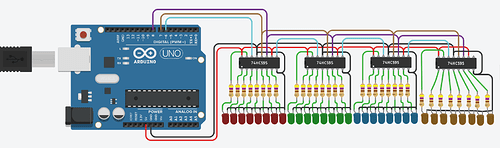

Today I would like to present a project that I have implemented in two versions. The project uses 12 shift registers 74HC595 and 96 LED diodes, Arduino Uno board with Ethernet shield Wiznet W5100. 8 LEDs are connected to each shift register. The numbers 0-9 are represented by LEDs. Each shift register is equipped with 8 output terminals.
Each of the 4 shift registers 74HC595 forms a logical unit - a display for listing a 4-digit number. In total, there are 3 logical displays in the project consisting of 12 shift registers.
The implementations are compatible for Arduino boards Nano, Mega, Uno and for Ethernet shields and modules from the Wiznet family, specifically models W5100 and W5500 (using the Ethernet2 library).

Cascade connection for shift registers 74HC595 (can be extended by x more) - Export from TinkerCAD:

It is clear from the diagram that only 3 data wires are used to control the shift registers:
Data output - (SER at 74HC595)
Clock signal - (SRCLK at 74HC595)
Latch output - (RCLK at 74HC595)
Shift registers can be combined in a cascade, while other peripherals can also be controlled by shift registers - for example, relays for switching power elements. It is also possible to control 500 separate relays (with a sufficient number of shift registers and power supply) with one data output.
