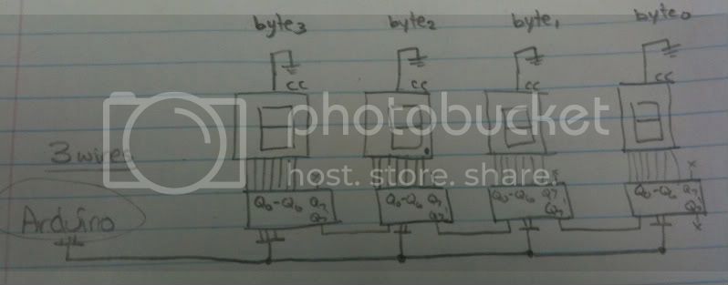

And so far, its working great! However, I plan on having four 7-seg displays per sensor (one per number, and two more at the end hard-wired to "°C"). Does this mean I will need four shift registers per sensor? I picked up four just in case (and if I dont need them Im sure I will use them in the future). What is the best way for me to connect all four displays? Other than the chip count, shift registers seem like a good way as I only need three wires per group of display. Im not looking for blocks of code at this point (however, if you have any I would definately appreciate them!); Im looking for ideas and suggestions. Please keep in mind that I do have a small programming background, but Im more of a hardware guy (Im in Uni for Electrical Engineering Tech), so you will most likely need to be basic with me for a little longer when it comes to code, until I catch on
