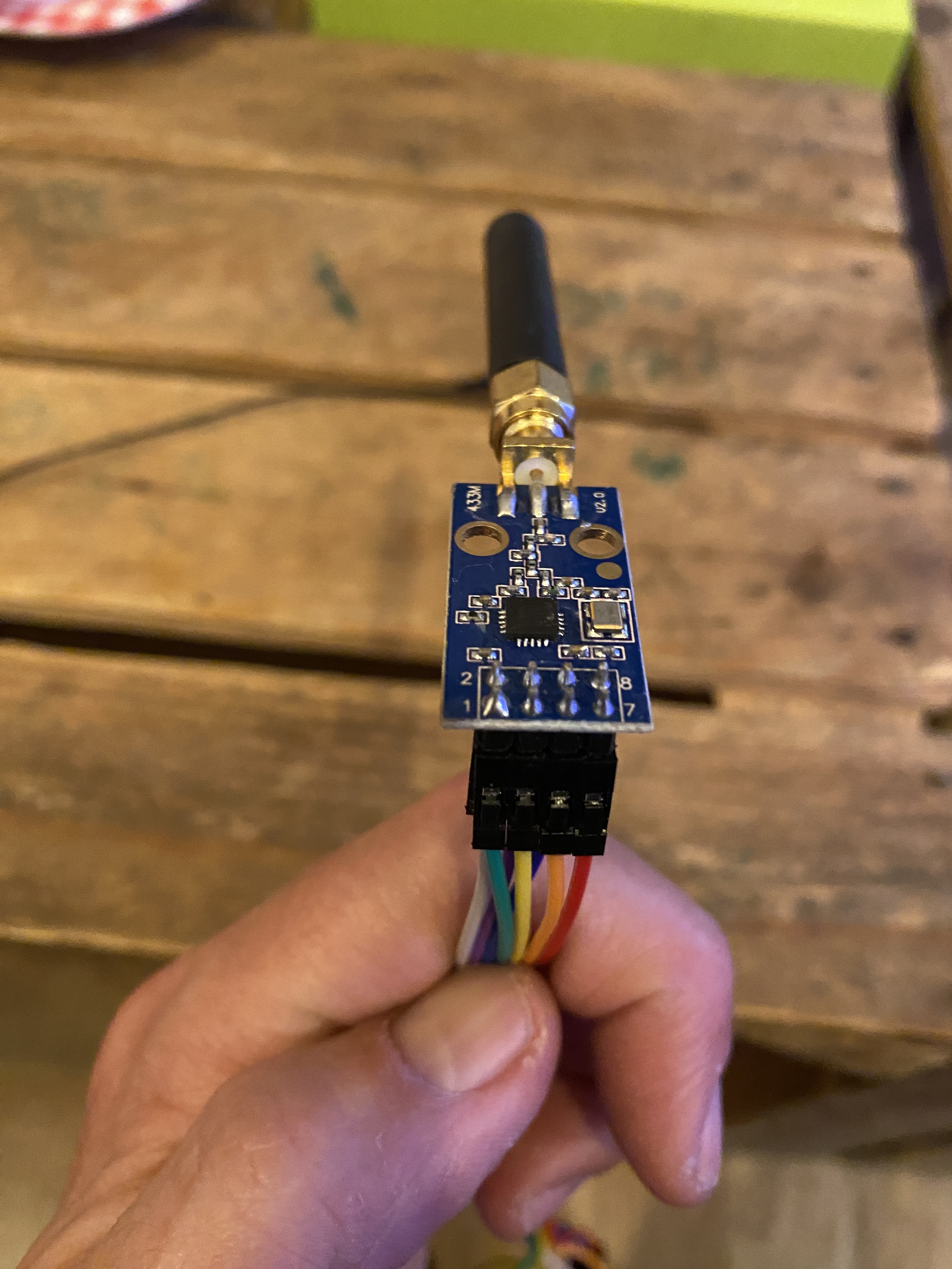

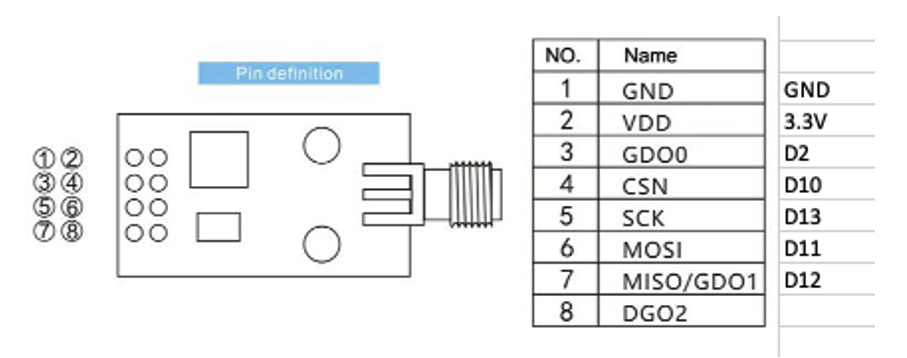

The problem is the CC1101 v1 is not more available in the Market. Now I have the CC1101 v2 (E07-M1101D) with only 8 connectors.
Captura de pantalla 2023-12-06 a las 19.24.34
I have reconnected all with the new board and use the same program but it is seemed that something is not working. It is like the are no communication. I do not know if I must configure the new board CC1101 v2
The failure message is:
I have tried to find something in Internet in order to solve it but I am not able to find nothing,.
I will be pleased if someone could help me.
Thanks in advance and regards from Spain

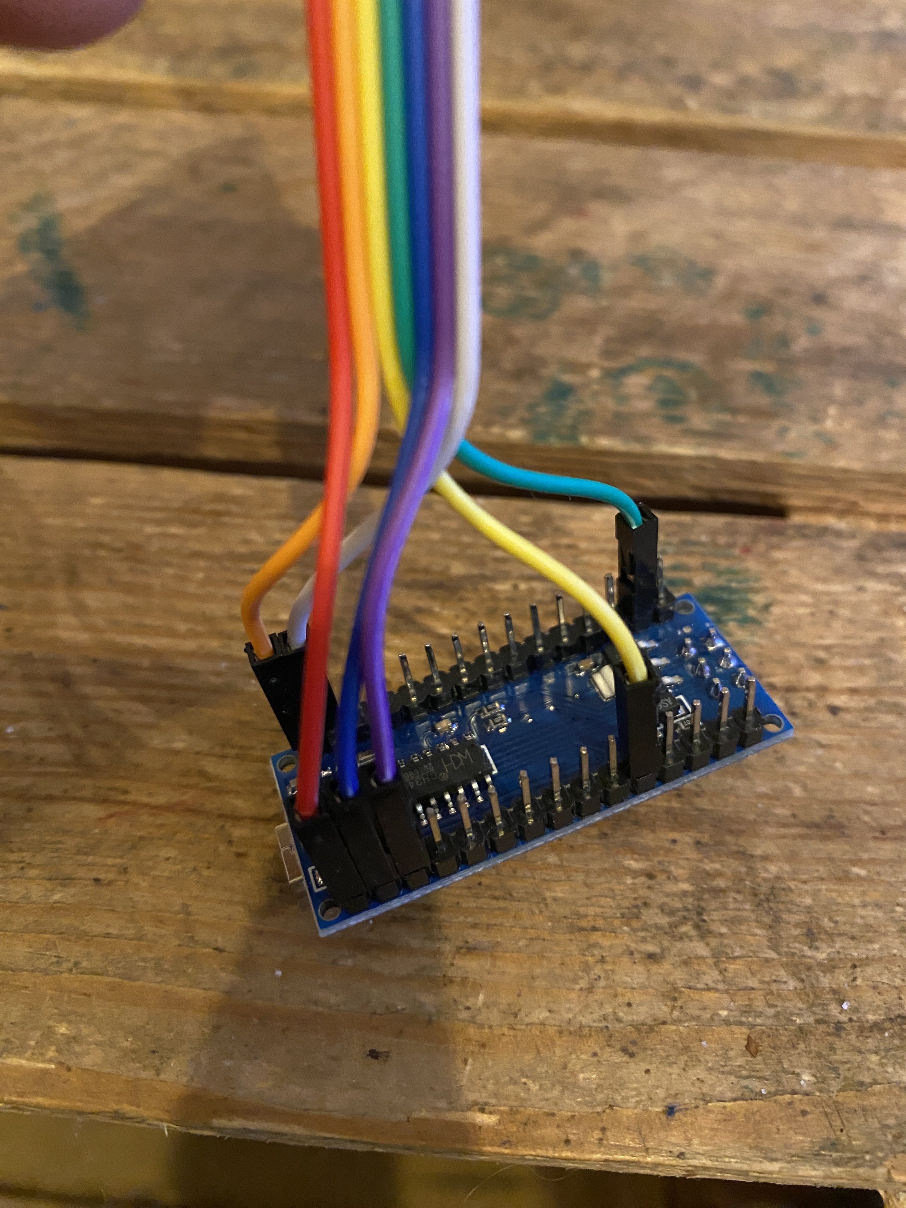

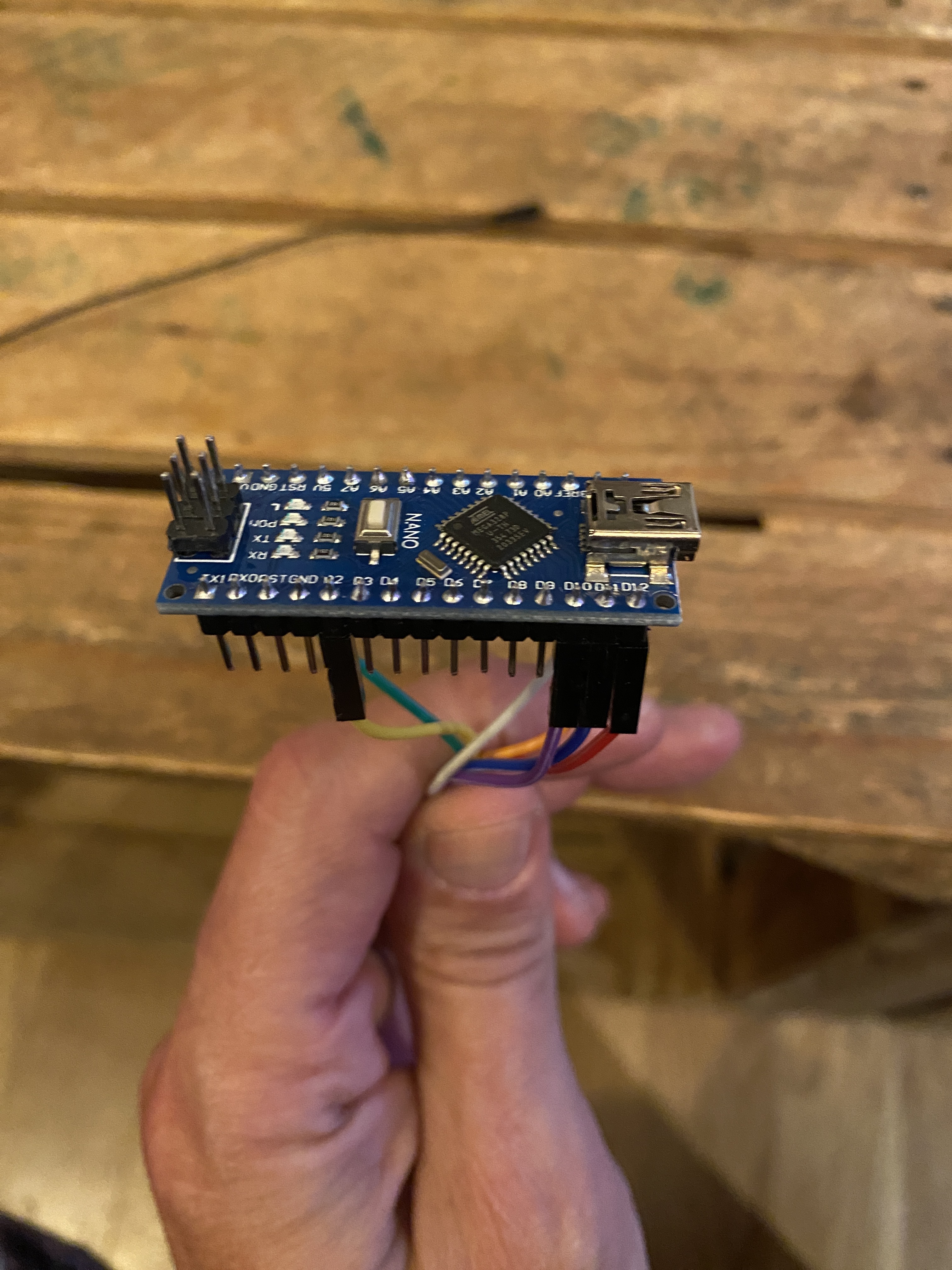

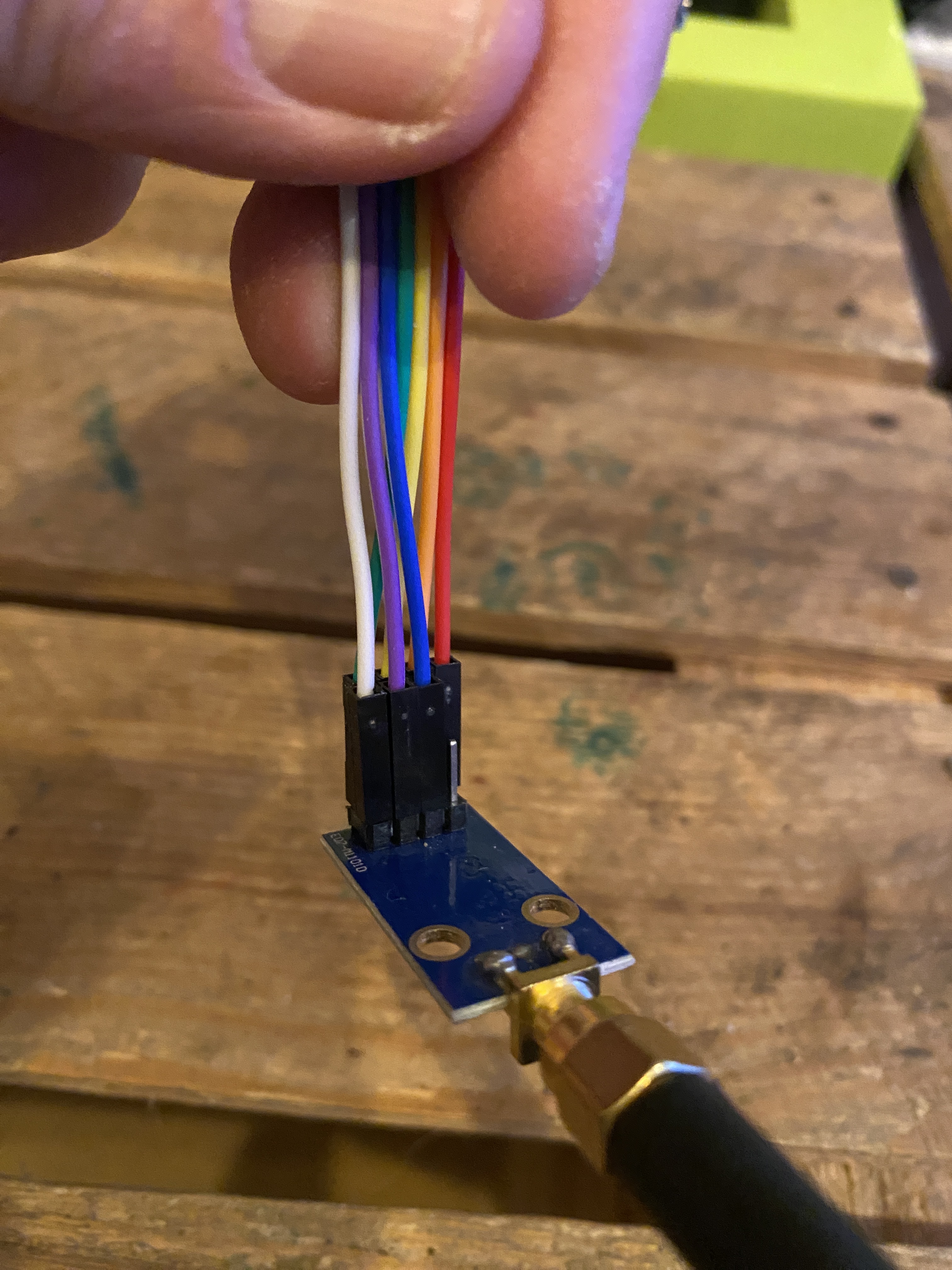

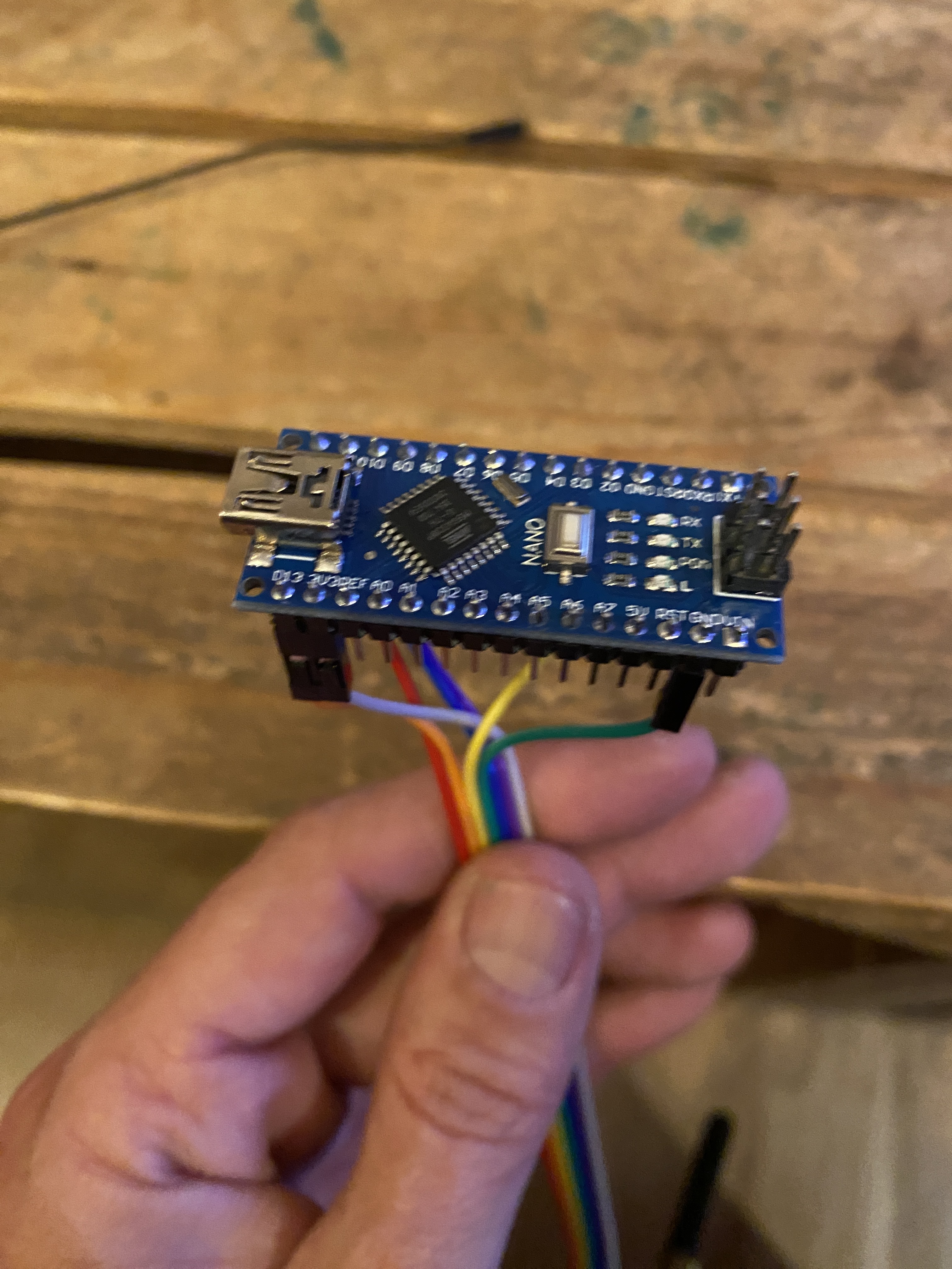

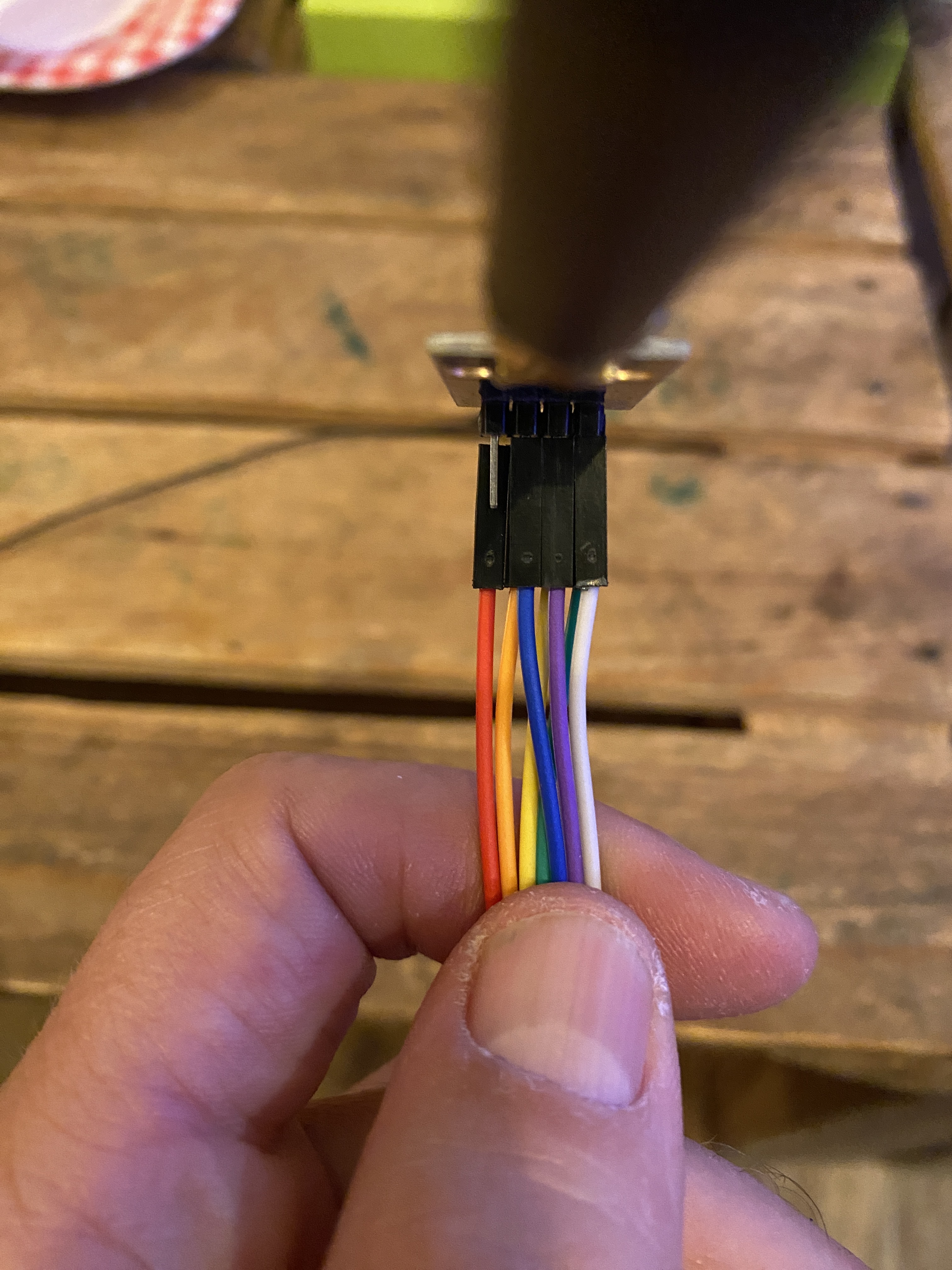

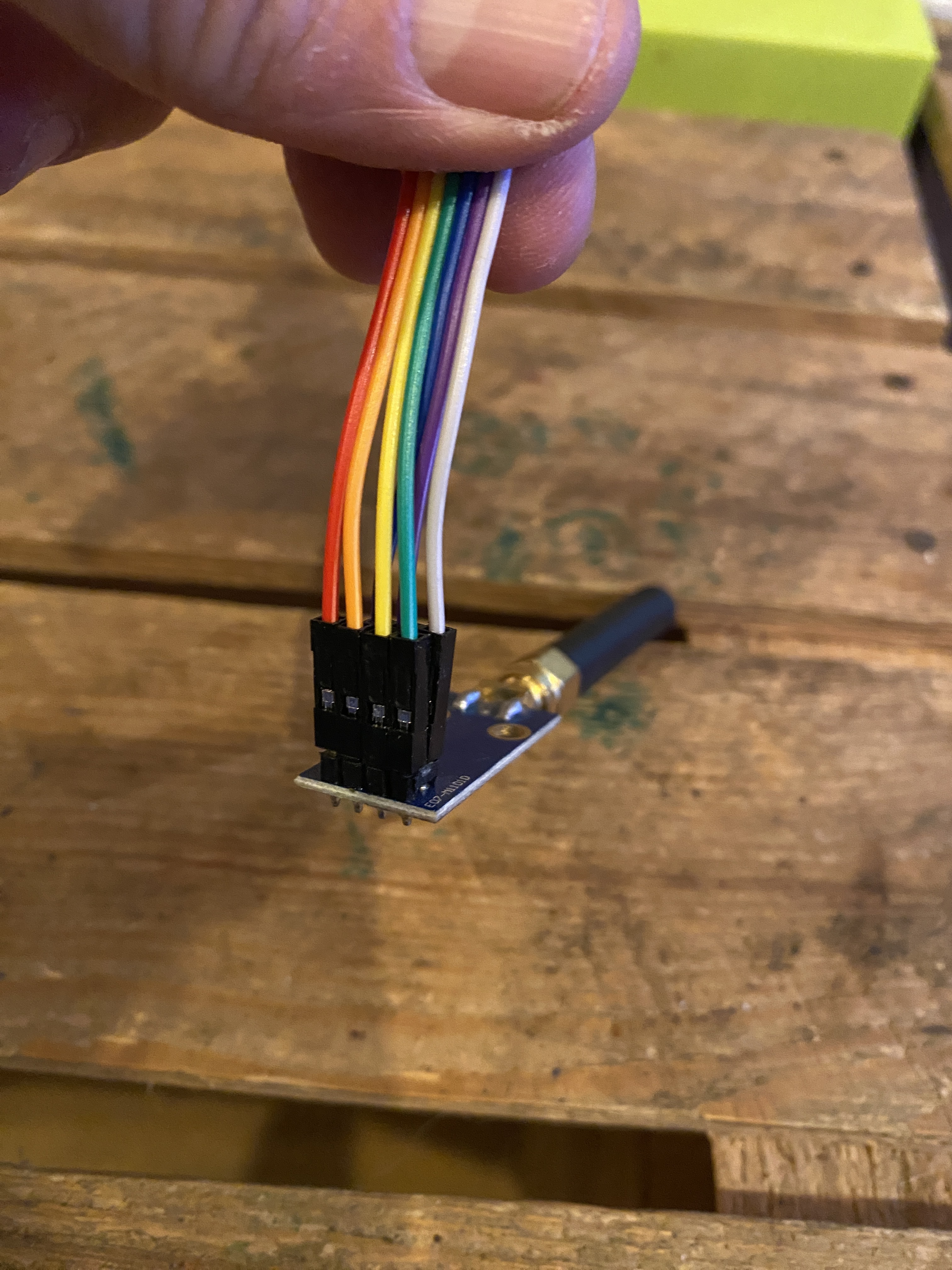

Maybe you could post some photos of the circuit. Bright, clear and taken from above so that all the wires can be traced.
I hope this photos are good enough
Did you have a look on the library's repo?
The wiring for the v1 module.
The wiring for the v2 module (that I bought here).

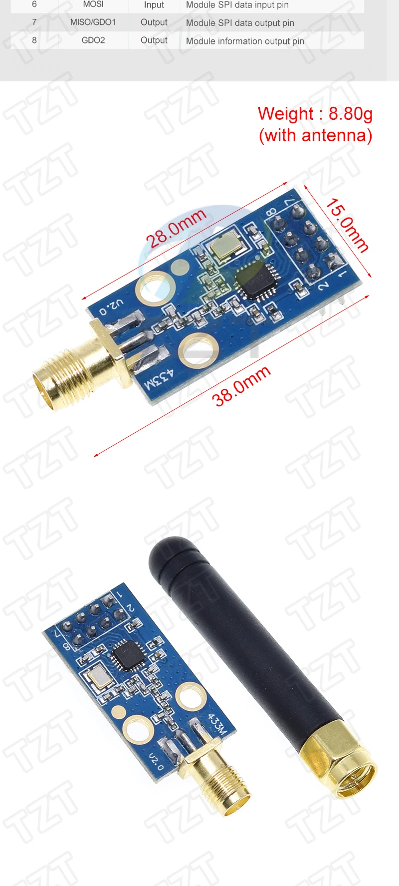

Well, cc1101 will transmit only a few meters with the original antenna (coil shown in your picture). you can improve gain by replacing coil antenna a length of coper wire or attach a better antenna product.
also, 5V will destroy cc1101. only use a 3.3V controller board. i use cc1101 + Pro Micro 8MHz (Leonardo clone) with SmartRC-CC1101-Driver-Lib-master library for sketch. This is an effective setup but the shorting procedure to program the board is very tedious.
your 6-pin cc1101 is arranged like this:
